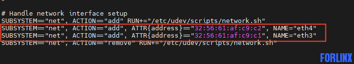

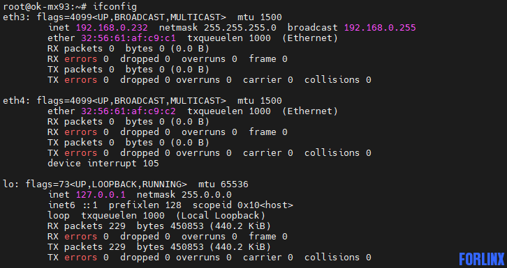

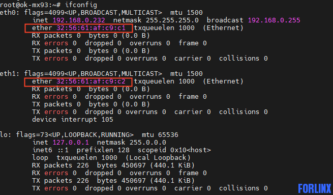

| 1.ifconfig查看网口mac地址 2.修改/etc/udev/rules.d/autonet.rules文件,添加如下语句,根据mac地址修改网口名称 SUBSYSTEM=="net", ACTION=="add", ATTR{address}=="32:56:61:af:c9:c2", NAME="eth4" SUBSYSTEM=="net", ACTION=="add", ATTR{address}=="32:56:61:af:c9:c1", NAME="eth3" |
