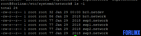

vi /etc/systemd/network/br0.netdev
填写以下内容:
[NetDev]
Name=br0
Kind=bridge
vi /etc/systemd/network/br0.network
填写以下内容:

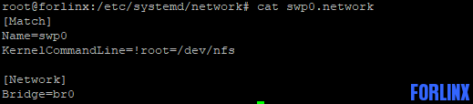

2. 绑定网口到网桥上,这里将swp0、swp1、swp2、swp3加入到br0中。需要分别 创建对应的4个文件。
touch /etc/systemd/network/swp0.network
touch /etc/systemd/network/swp1.network
touch /etc/systemd/network/swp2.network
touch /etc/systemd/network/swp3.network
 每个文件的内容和如下swp0.network内容类似,但是 [Name=swp0] 属性不一样,要和文件名对应。
 swp0.network
[Match]
Name=swp0
KernelCommandLine=!root=/dev/nfs
[Network]
Bridge=br0

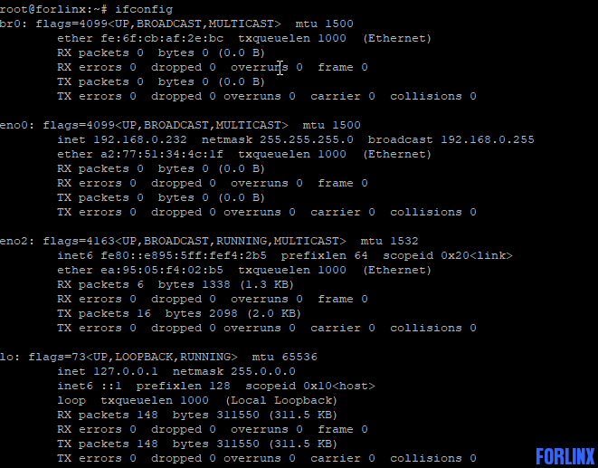

Ifconfig 查看节点:
