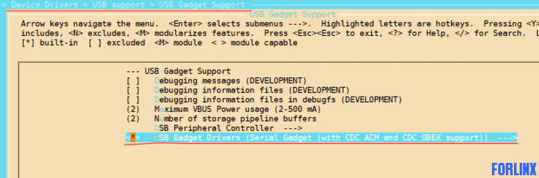

修改内核配置
重新编译烧写镜像后,在文件系统输入以下命令
开启连接
echo connect > /sys/devices/soc.0/1c13000.udc-controller/udc/1c13000.udc-controller/soft_connect
断开连接
echo disconnect > /sys/devices/soc.0/1c13000.udc-controller/udc/1c13000.udc-controller/soft_connect
