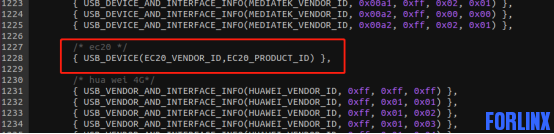

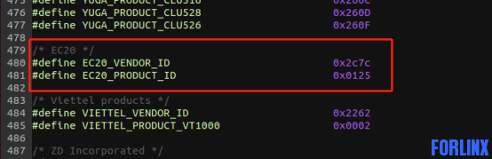

1、vim drivers/usb/serial/option.c
添加下面内容到下图红框位置
/* EC20 */
#define EC20_VENDOR_ID                         0x2c7c
#define EC20_PRODUCT_ID                        0x0125
2、
/* ec20 */
{ USB_DEVICE(EC20_VENDOR_ID,EC20_PRODUCT_ID) },

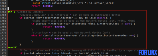

3、
#if 1 //Added by Quectel
        //Quectel modulesm~@~Ys inte**ce 4 can be used as USBnetwork device
        if (serial->dev->descriptor.idVendor == cpu_to_le16(0x2C7C)) {
                //some inte**ces can be used as USB Network device (ecm, rndis, mbim)
                if (serial->inte**ce->cur_altsetting->desc.bInte**ceClass != 0xFF) {
                        return -ENODEV;
                //inte**ce 4 can be used as USB Network device (qmi)
                else if (serial->inte**ce->cur_altsetting->desc.bInte**ceNumber >=4) {
                        return -ENODEV;
#endif
