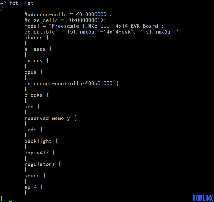

fdt list 查看设备树缩略节点

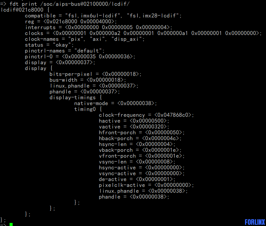

fdt print /soc/aips-bus@02100000/lcdif/   打印lcdif节点信息
fdt print /soc/aips-bus@02100000/lcdif/display/display-timings/timing0 hactive  打印lcd的hactive项
fdt set /soc/aips-bus@02100000/lcdif/display/display-timings/timing0 hactive <0x00000600> 将hactive修改为<0x00000600>
