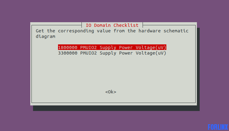

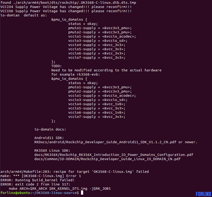

图像界面配置错误电压域,会出现以下报错信息,解决方法如下:

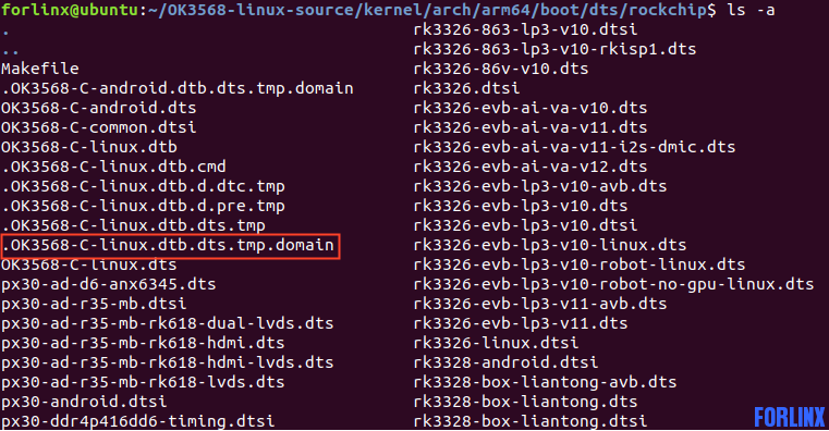

删除.OK3568-C-linux.dtb.dts.tmp.domain文件
forlinx@ubuntu:~/OK3568-linux-source/kernel/arch/arm64/boot/dts/rockchip$ ls -a
forlinx@ubuntu:~/OK3568-linux-source/kernel/arch/arm64/boot/dts/rockchip$ rm .OK3568-C-linux.dtb.dts.tmp.domain
重新编译镜像
forlinx@ubuntu:~/OK3568-linux-source$ ./build.sh

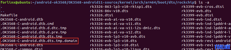

删除.OK3568-C-android.dtb.dts.tmp.domain文件
forlinx@ubuntu:~/android-ok3568/OK3568-android11-source/kernel/arch/arm64/boot/dts/rockchip$ ls -a
forlinx@ubuntu:~/android-ok3568/OK3568-android11-source/kernel/arch/arm64/boot/dts/rockchip$ rm .OK3568-C-android.dtb.dts.tmp.domain
重新编译镜像
forlinx@ubuntu:~/android-ok3568/OK3568-android11-source$ source build/envsetup.sh
forlinx@ubuntu:~/android-ok3568/OK3568-android11-source$ lunch ok3568_r-userdebug
forlinx@ubuntu:~/android-ok3568/OK3568-android11-source$ ./build.sh -UKAup
