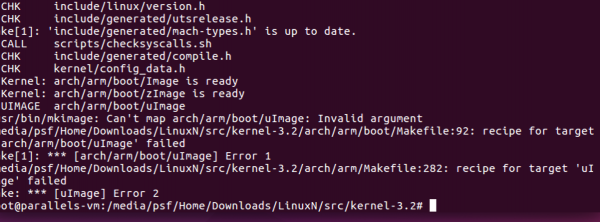

内核编译到最后报错这个,是怎么回事?/usr/bin/mkimage: Can't map arch/arm/boot/uImage: Invalid argument
/media/psf/Home/Downloads/LinuxN/src/kernel-3.2/arch/arm/boot/Makefile:92: recipe for target 'arch/arm/boot/uImage' failed
make[1]: *** [arch/arm/boot/uImage] Error 1
/media/psf/Home/Downloads/LinuxN/src/kernel-3.2/arch/arm/Makefile:282: recipe for target 'uImage' failed
make: *** [uImage] Error 2

你好 这种情况可能是 mkimage文件的问题 你可以下载最新资料中的mkimage 重新尝试
