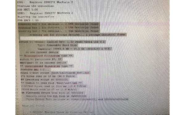

使用的手册是v1.1_2019.07.30版本,现在我插入u盘启动,没有自动烧写,还是直接起来了,过程中有如图打印  详情 回复 发表于 2019-12-20 15:08
scanning bus 0 for devices... 2 USB Device(s) found scanning bus 1 for devices... 1 USB Device(s) found scanning bus 2 for devices... 1 USB Device(s) found scanning usb for storage devices..  详情 回复 发表于 2019-12-20 15:19
31
53
楼主| Jarvis.Z 发表于 2019-12-20 15:19:56 | 显示全部楼层
       scanning usb for storage devices... 1 Storage Device(s) found
Device 0: Vendor: SanDisk Rev: 1.00 Prod: Ultra USB 3.0
            Type: Removable Hard Disk
            Capacity: 14663.6 MB = 14.3 GB (30031250 x 512)
... is now current device
** Unrecognized filesystem type **
switch to partitions #0, OK
mmc0(part 0) is current device
Scanning mmc 0:2...
Found U-Boot script /boot/ls1043ardb_boot.scr
872 bytes read in 18 ms (46.9 KiB/s)
## Executing script at 80000000
** Unable to read file /boot/uEnv.txt **
21522944 bytes read in 1102 ms (18.6 MiB/s)
29406 bytes read in 17 ms (1.6 MiB/s)
## Flattened Device Tree blob at 90000000
   Booting using the fdt blob at 0x90000000
   Using Device Tree in place at 0000000090000000, end 000000009001a2dd
1190
2222

1046是吧,图看不清,把打印信息整个复制下来
localhost login: U-Boot 2018.03 (Aug 15 2019 - 01:53:03 +0000) SoC: LS1043AE Rev1.1 (0x87920211) Clock Configuration: CPU0(A53):1600 MHz CPU1(A53):1600 MHz CPU2(A53):1600 MHz  详情 回复 发表于 2019-12-20 15:35

1190
2222
Forlinx-Niuzc 发表于 2019-12-20 16:26:48 | 显示全部楼层
系统文件没有识别,用软件格式化u盘,比如HPUSBFW.EXE,重新烤镜像到u盘
谢谢,格式化之后烧写就正常了。我看文档中描述烧写完成后需要配置一些命令,这些配置命令每次烧写后都需要执行吗?这些功能或这些配置能在制作镜像时就加入吗?  详情 回复 发表于 2019-12-20 17:44
31
53
楼主| Jarvis.Z 发表于 2019-12-20 17:44:53 | 显示全部楼层
1190
2222
Forlinx-Niuzc 发表于 2019-12-21 09:01:27 | 显示全部楼层
每次烧写后都需要执行,您可自行尝试将其加入到镜像中,我们暂时没有做过
