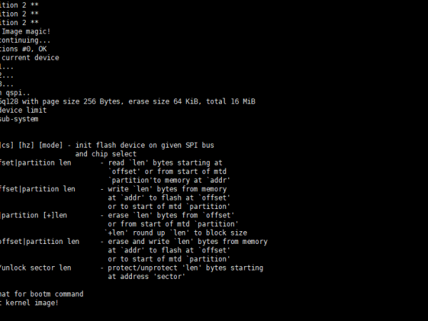

1043用U盘烧写报错,用了SD卡也不行,怎么解决?谢谢!

楼主| greyapple 发表于 2020-5-6 14:46:43 | 显示全部楼层
U-Boot 2018.03 (Aug 21 2019 - 16:34:34 +0800)
SoC:  LS1043AE Rev1.1 (0x87920211)
Clock Configuration:
       CPU0(A53):1600 MHz  CPU1(A53):1600 MHz  CPU2(A53):1600 MHz
       CPU3(A53):1600 MHz
       Bus:      400  MHz  DDR:      1600 MT/s  FMAN:     500  MHz
Reset Configuration Word (RCW):
       00000000: 08100010 0a000000 00000000 00000000
       00000010: 14550002 80004012 40044000 c1002000
       00000020: 00000000 00000000 00000000 00238800
       00000030: 20044500 00001102 00000096 00000001
Model: OK1043-C
Board: LS1043ARDB, boot from QSPI
SERDES Reference Clocks:
SD1_CLK1 = 156.25MHZ, SD1_CLK2 = 100.00MHZ
I2C:   ready
DRAM:  Initialzing DDR using fixed setting
Configuring DDR for 1600 MT/s data rate
1.9 GiB (DDR4, 32-bit, CL=11, ECC off)
DS2460 OK
Using SERDES1 Protocol: 5205 (0x1455)
SEC0: RNG instantiated
PPA Firmware: Version LSDK-18.06-Forlinx
SEC Firmware: 'loadables' present in config
loadables: 'trustedOS@1'
MMC:   FSL_SDHC: 0
Loading Environment from SPI Flash... SF: Detected n25q128 with page size 256 Bytes, erase size 64 KiB, total 16 MiB
OK
In:    serial
Out:   serial
Err:   serial
SATA link 0 timeout.
AHCI 0001.0301 32 slots 1 ports 6 Gbps 0x1 impl SATA mode
flags: 64bit ncq pm clo only pmp fbss pio slum part ccc apst
Found 0 device(s).
SCSI:  Net:   SF: Detected n25q128 with page size 256 Bytes, erase size 64 KiB, total 16 MiB
Fman1: Uploading microcode version 106.4.18
Could not get PHY for FSL_MDIO0: addr 8
Failed to connect
Could not get PHY for FSL_MDIO0: addr 9
Failed to connect
Could not get PHY for FSL_MDIO0: addr 10
Failed to connect
Could not get PHY for FSL_MDIO0: addr 11
Failed to connect
Could not get PHY for FM_TGEC_MDIO: addr 0
Failed to connect
PCIe0: pcie@3400000 disabled
PCIe1: pcie@3500000 Root Complex: no link
PCIe2: pcie@3600000 Root Complex: no link
FM1@DTSEC1, FM1@DTSEC2, FM1@DTSEC3 [PRIME], FM1@DTSEC4, FM1@DTSEC5, FM1@DTSEC6, FM1@TGEC1
Hit any key to stop autoboot:  0
=> boot
starting USB...
USB0:   Register 200017f NbrPorts 2
Starting the controller
USB XHCI 1.00
USB1:   Register 200017f NbrPorts 2
USB XHCI 1.00
USB2:   Register 200017f NbrPorts 2
USB XHCI 1.00
scanning bus 0 for devices... 5 USB Device(s) found
scanning bus 1 for devices... 1 USB Device(s) found
scanning bus 2 for devices... 1 USB Device(s) found
       scanning usb for storage devices... 1 Storage Device(s) found
Device 0: Vendor:  Rev: 1.00 Prod:
            Type: Removable Hard Disk
            Capacity: 7424.0 MB = 7.2 GB (15204352 x 512)
... is now current device
Scanning usb 0:4...
Found U-Boot script /ls1043ardb_update.scr
365 bytes read in 20 ms (17.6 KiB/s)
## Executing script at 80000000
** Invalid partition 1 **
Wrong Image Format for bootm command
ERROR: can't get kernel image!
SCRIPT FAILED: continuing...
Found U-Boot script /boot/ls1043ardb_boot.scr
872 bytes read in 30 ms (28.3 KiB/s)
** Invalid partition 3 **
** Invalid partition 2 **
Bad Linux ARM64 Image magic!
switch to partitions #0, OK
mmc0(part 0) is current device
Scanning mmc 0:1...
Scanning mmc 0:2...
Scanning mmc 0:3...
Trying load from qspi..
Offset exceeds device limit
sf - SPI flash sub-system
Usage:
sf probe [[bus:]cs] ** [mode]        - init flash device on given SPI bus
                                  and chip select
sf read addr offset|partition len        - read `len' bytes starting at
                                          `offset' or from start of mtd
                                          `partition'to memory at `addr'
sf write addr offset|partition len        - write `len' bytes from memory
                                          at `addr' to flash at `offset'
                                          or to start of mtd `partition'
sf erase offset|partition [+]len        - erase `len' bytes from `offset'
                                          or from start of mtd `partition'
                                         `+len' round up `len' to block size
sf update addr offset|partition len        - erase and write `len' bytes from memory
sf protect lock/unlock sector len        - protect/unprotect 'len' bytes starting
                                          at address 'sector'
100

xhh 发表于 2020-6-9 14:18:07 | 显示全部楼层
不知道您的问题解决了没有,回答问题有遗漏实在抱歉,如果有着急的问题可以直接拨打我们技术支持电话。SD卡引导没问题,在U盘烧写的时候报错,您烧写的是不是出厂镜像,底板是否为我们的底板
