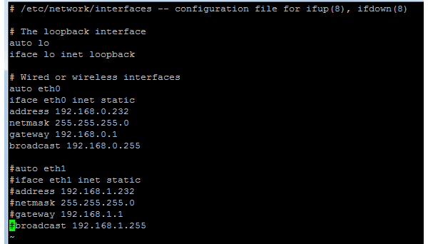

倔强的土坷垃 发表于 2020-7-10 11:57:22 | 显示全部楼层
查看一下etc/network/inte**ces文件,默认是将ETH1屏蔽掉了。删除屏蔽再试一下。

倔强的土坷垃 发表于 2020-7-10 11:59:28 | 显示全部楼层
查看inte**ce文件

楼主| niuyang 发表于 2020-7-10 12:43:41 | 显示全部楼层
应该是打开了,我刷的是console的文件系统,缺省就是打开的
root@freescale ~$ cat /etc/network/inte**ces
# /etc/network/inte**ces -- configuration file for ifup(8), ifdown(8)
# The loopback inte**ce
auto lo
iface lo inet loopback
# Wired or wireless inte**ces
auto eth0
iface eth0 inet static
address 192.168.0.232
netmask 255.255.255.0
gateway 192.168.0.1
broadcast 192.168.0.255
auto eth1
iface eth1 inet static
address 192.168.1.232
gateway 192.168.1.1
broadcast 192.168.1.255
root@freescale ~$
