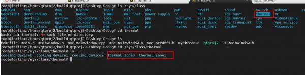

首先是读写两个CPUzone的温度,需要读取/sys/class/thermal/thermal_zone0/temp和/sys/class/thermal/thermal_zone1/temp:

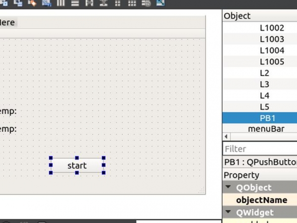

QThread线程就只拿来读取CPU0温度,CPU1温度和ADC_IN4通道,Qthread线程的运行和暂停又一个按钮来控制:
  1. void MainWindow::on_PB1_clicked()
  2. {
  3.     disconnect(ui->PB1,SIGNAL(clicked()),this,SLOT(on_PB1_clicked()));
  4.     connect(ui->PB1,SIGNAL(clicked()),this,SLOT(on_PB1_clicked_2()));
  5.     ui->PB1->setText("Pause");
  6.     thread1->start();
  7. }
  8. void MainWindow::on_PB1_clicked_2()
  9. {
  10.     disconnect(ui->PB1,SIGNAL(clicked()),this,SLOT(on_PB1_clicked_2()));
  11.     connect(ui->PB1,SIGNAL(clicked()),this,SLOT(on_PB1_clicked()));
  12.     ui->PB1->setText("Start");
  13.     thread1->closeThread();
  14.     thread1->wait();
  15. }
