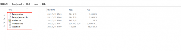

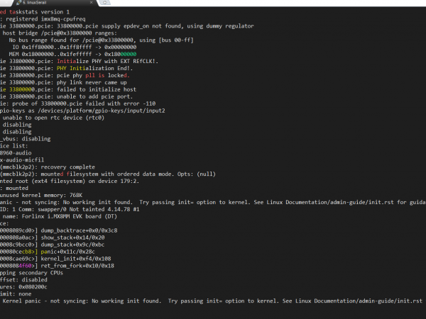

按照教程,配置好uuu,拨码开关设置好,内核启动到一半出现 end Kernel panic错误,下面的日志如下,请问这是啥问题导致的? linux3.png linux2.png linux1.png

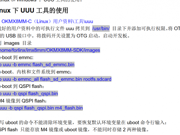

您用UUU烧写执行了哪些指令啊?能发一下串口打印信息吗?
您尝试过用TF卡烧写吗?
下面是uuu设置的步骤: alban@alban-pc:~/linux/atk-mp1/linux-5.4.31-g265df13e0-v1.0$ cd alban@alban-pc:~$ cd linux/imx8mm/ alban@alban-pc:~/linux/imx8mm$ ls images linux-imx tool toolChain uboot  详情 回复 发表于 2021-5-17 19:29

也试过SD卡也不行,下面是启动日志:

[    3.872871] EXT4-fs (mmcblk2p2): recovery complete
[    3.877714] EXT4-fs (mmcblk2p2): mounted filesystem with ordered data mode. Opts: (null)
[    3.885889] VFS: Mounted root (ext4 filesystem) on device 179:2.
[    3.893911] devtmpfs: mounted
[    3.897219] Freeing unused kernel memory: 768K
[    3.904255] Kernel panic - not syncing: No working init found.  Try passing init= option to kernel. See Linux Documentation/admin-guide/init.rst for guidance.
[    3.918426] CPU: 1 PID: 1 Comm: swapper/0 Not tainted 4.14.78 #1
[    3.924429] Hardware name: Forlinx i.MX8MM EVK board (DT)
[    3.929825] Call trace:
[    3.932281] [<ffff000008089cd0>] dump_backtrace+0x0/0x3c8
[    3.937679] [<ffff00000808a0ac>] show_stack+0x14/0x20
[    3.942733] [<ffff000008c9bcc0>] dump_stack+0x9c/0xbc
[    3.947784] [<ffff0000080cecb8>] panic+0x11c/0x28c
[    3.952574] [<ffff000008cae69c>] kernel_init+0xf4/0x108
[    3.957798] [<ffff000008084f60>] ret_from_fork+0x10/0x18
[    3.963112] SMP: stopping secondary CPUs
[    3.967563] Kernel Offset: disabled
[    3.971051] CPU features: 0x080200c
[    3.974537] Memory Limit: none
[    3.977594] ---[ end Kernel panic - not syncing: No working init found.  Try passing init= option to kernel. See Linux Documentation/admin-guide/init.rst for guidance.

djh 发表于 2021-5-17 09:12
应该是没烧写成功
您尝试过用TF卡烧写吗?
下面是uuu设置的步骤:
images  linux-imx  tool  toolChain  uboot-imx
alban@alban-pc:~/linux/imx8mm$ cd images/
alban@alban-pc:~/linux/imx8mm/images$ ls
flash_qspi.bin  flash_sd_emmc.bin  readme.txt  rootfs.sdcard  update.itb
alban@alban-pc:~/linux/imx8mm/images$ sudo uuu -b emmc flash_sd_emmc.bin
[sudo] password for alban:
uuu (Universal Update Utility) for nxp imx chips -- libuuu_1.2.91-0-g3799f4d
Success 1    Failure 0
3:2    3/ 3   [============100%============] SDPU: jump
alban@alban-pc:~/linux/imx8mm/images$      ] FB: Done
alban@alban-pc:~/linux/imx8mm/images$  sudo uuu -b emmc_all flash_sd_emmc.bin rootfs.sdcard
Success 1    Failure 0
3:41   8/ 8   [Done                        ] FB: done
alban@alban-pc:~/linux/imx8mm/images$ sudo uuu -b qspi flash_qspi.bin
Success 1    Failure 0
3:41   6/ 6   [Done                        ] FB: done
