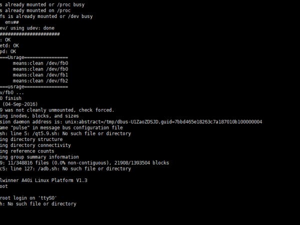

我这边没有使用底板,纯核心板启动,只引出了几个串口,从Debug串口看启动是正常的,但是启动完成进入后就卡死了,输入任何命令都没有反馈;
放回核心板是OK的,请问这个是什么问题?

楼主| xiaojia-tech 发表于 2021-7-2 10:07:24 | 显示全部楼层
zhichao 发表于 2021-7-2 08:54
您有修改过镜像吗,您把完整开机打印信息发过来看看吧,这些打印信息有点少,没法定位原因
没有修改过镜像,完整打印信息如下:

[/init]: RootDevice is "/dev/mmcblk0p7"
[/init]: Try to load EMMC ...
e2fsck 1.41.14 (22-Dec-2010)
/dev/mmcblk0p7: recovering journal
/dev/mmcblk0p7: clean, 9640/11520 files, 502492/1965588 blocks
mount: proc is already mounted or /proc busy
       proc is already mounted on /proc
mount: devtmpfs is already mounted or /dev busy
init asteroid  env##
Populating /dev/ using udev: done
init qt env########################
Starting sshd: OK
Starting telnetd: OK
Starting vsftpd: OK
================Usrage================
/fbinit           means:clean /dev/fb0
/fbinit 0          means:clean /dev/fb0
/fbinit 1          means:clean /dev/fb1
/fbinit 2          means:clean /dev/fb2
================usrage================
cleanning /dev/fb0 ...
clean /dev/fb0 finish
e2fsck 1.43.3 (04-Sep-2016)
/dev/mmcblk0p9 was not cleanly unmounted, check forced.
Pass 1: Checking inodes, blocks, and sizes
D-Bus per-session daemon address is: unix:abstract=/tmp/dbus-4mNyUVGKYu,guid=61558b83ea90f8b306aaedf200000004
Unknown username "pulse" in message bus configuration file
/etc/autorun.sh: line 5: /qt5.9.sh: No such file or directory
Pass 2: Checking directory structure
Pass 3: Checking directory connectivity
Pass 4: Checking reference counts
Pass 5: Checking group summary information
/dev/mmcblk0p9: 11/348816 files (0.0% non-contiguous), 21908/1393504 blocks
/etc/init.d/rcS: line 127: /adb.sh: No such file or directory
Welcome to Allwinner A40i Linux Platform V1.3
A40i login: root
Password:
login[1284]: root login on 'ttyS0'
-sh: /qt5.9.sh: No such file or directory
