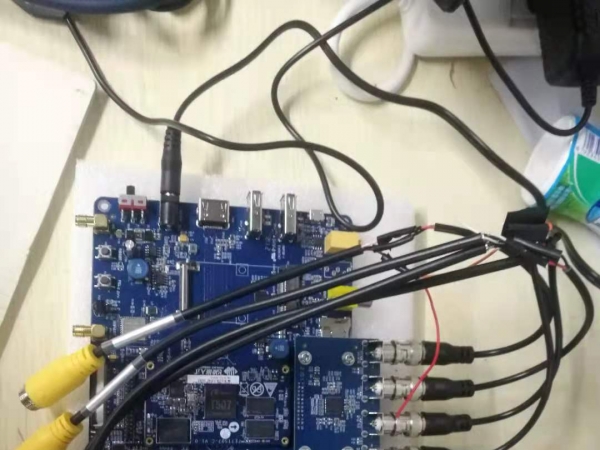

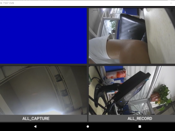

首先上图:专门购买了,飞淩提供的转接板,来测试此方案,为后面有此想法的公司或者人员提供参考,只做最真实的测评由于只找到3路AHD摄像头,只有三个画面,手动更换摄像头,第4路是可以点亮的,忽略附件中连线,自己做的线,比较丑

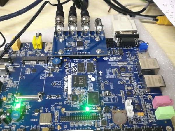

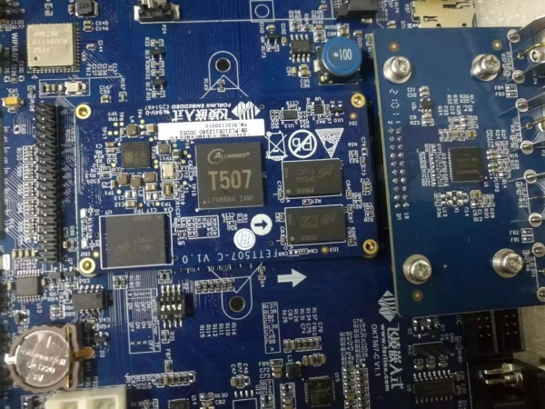

2、板子采用底板+核心板+AHD转接板,硬件做工非常棒设计很实用方便,AHD转接板采用TP2854方案,mipi转4路AHD,能满足大部分车载场景
3、4路摄像头top指令运行结果:
   Tasks: 214 total,   5 running, 209 sleeping,   0 stopped,   0 zombie
  Mem:      1.9G total,      956M used,      1.0G free,      1.9M buffers
Swap:      1.4G total,         0 used,      1.4G free,      449M cached
400%cpu 106%user   1%nice 107%sys 184%idle   0%iow   0%irq   2%sirq   0%host
  PID USER         PR  NI VIRT  RES  SHR S[%CPU] %MEM     TIME+ ARGS
1948 system       -2 -20 133M  34M  24M R 92.0   1.6  21:54.83 su**ceflinger
1338 root         20   0  12M 5.6M 4.5M R 23.0   0.2  38:02.52 ueventd
1935 system       -3  -8 113M 8.1M 6.6M S 22.3   0.4   9:12.15 android.hardware.graphics.composer@2.1-service
2159 cameraserver 20   0 100M  12M  10M S 15.0   0.6   2:48.23 android.hardware.camera.provider@2.4-service-lazy
2010 mediacodec   20   0  66M  14M  12M S 13.3   0.7   2:52.00 media.codec hw/android.hardware.media.omx@1.0-service
1976 cameraserver 20   0  99M  25M  21M S 11.0   1.2   2:07.89 cameraserver
23651 shell        20   0 917M  71M  55M S  8.6   3.5   1:44.70 app_process / com.genymobile.scrcpy.Server 0 8000000 false - true t+
1971 shell        20   0  24M 4.9M 3.9M S  5.3   0.2   1:10.40 adbd --root_seclabel=u:r:su:s0
1685 root         20   0 9.4M 3.5M 2.8M R  4.3   0.1   0:00.76 top -m 10
1816 root         20   0  21M 5.9M 4.9M S  4.0   0.2   4:06.38 vold --blkid_context=u:r:blkid:s0 --blkid_untrusted_context=u:r:blk+
