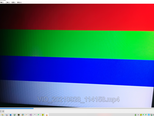

安卓系统下修改完sys_config.fex文件后LVDS屏幕显示这样,这是什么问题?
下面是配置文件的详细内容
[lcd0]
lcd_used            = 1
lcd_driver_name     = "default_lcd"
lcd_backlight       = 255
lcd_if              = 3
lcd_x               = 1366
lcd_y               = 768
lcd_width           =
lcd_height          =
lcd_dclk_freq       = 60
lcd_pwm_used        = 0
lcd_pwm_ch          = 0
lcd_pwm_freq        = 50000
lcd_pwm_pol         = 0
lcd_pwm_max_limit   = 255
lcd_hbp             = 60
lcd_ht              = 1440
lcd_hspw            = 60
lcd_vbp             = 10
lcd_vt              = 1800
lcd_vspw            = 40
lcd_lvds_if         = 1
lcd_lvds_colordepth = 0
lcd_lvds_mode       = 0
lcd_frm             = 1
lcd_hv_clk_phase    = 0
lcd_hv_sync_polarity= 0
lcd_gamma_en        = 0
lcd_bright_curve_en = 0
lcd_cmap_en         = 0
deu_mode            = 1
lcdgamma4iep        = 22
smart_color         = 90
lcd_bl_en           = port:PB09<1><0><default><1>
lcd_power           = "vcc-lcd"
lcdd0                   = port:PD00<2><0><default><default>
lcdd1                   = port:PD01<2><0><default><default>
lcdd2                   = port:PD02<2><0><default><default>
lcdd3                   = port:PD03<2><0><default><default>
lcdd4                   = port:PD04<2><0><default><default>
lcdd5                   = port:PD05<2><0><default><default>
lcdd6                   = port:PD06<2><0><default><default>
lcdd7                   = port:PD07<2><0><default><default>
lcdd8                   = port:PD08<2><0><default><default>
lcdd9                   = port:PD09<2><0><default><default>
lcdd10                  = port:PD10<2><0><default><default>
lcdd11                  = port:PD11<2><0><default><default>
lcdd12                  = port:PD12<2><0><default><default>
lcdd13                  = port:PD13<2><0><default><default>
lcdd14                  = port:PD14<2><0><default><default>
lcdd15                  = port:PD15<2><0><default><default>
lcdd16                  = port:PD16<2><0><default><default>
lcdd17                  = port:PD17<2><0><default><default>
lcdd18                  = port:PD18<2><0><default><default>
lcdd19                  = port:PD19<2><0><default><default>
;lcdd20                  = port:PD20<2><0><default><default>
;lcdd21                  = port:PD21<2><0><default><default>
;lcdd22                  = port:PD22<2><0><default><default>
;lcdd23                  = port:PD23<2><0><default><default>
;lcdclk                  = port:PD24<2><0><default><default>
;lcdde                   = port:PD25<2><0><default><default>
;lcdhsync                = port:PD26<2><0><default><default>
;lcdvsync                = port:PD27<2><0><default><default>
[lcd0_suspend]
lcdd0               = port:PD00<7><0><default><default>
lcdd1               = port:PD01<7><0><default><default>
lcdd2               = port:PD02<7><0><default><default>
lcdd3               = port:PD03<7><0><default><default>
lcdd4               = port:PD04<7><0><default><default>
lcdd5               = port:PD05<7><0><default><default>
lcdd6               = port:PD06<7><0><default><default>
lcdd7               = port:PD07<7><0><default><default>
lcdd8               = port:PD08<7><0><default><default>
lcdd9               = port:PD09<7><0><default><default>
lcdd10                  = port:PD10<7><0><default><default>
lcdd11                  = port:PD11<7><0><default><default>
lcdd12                  = port:PD12<7><0><default><default>
lcdd13                  = port:PD13<7><0><default><default>
lcdd14                  = port:PD14<7><0><default><default>
lcdd15                  = port:PD15<7><0><default><default>
lcdd16                  = port:PD16<7><0><default><default>
lcdd17                  = port:PD17<7><0><default><default>
lcdd18                  = port:PD18<7><0><default><default>
lcdd19                  = port:PD19<7><0><default><default>
;lcdd20                  = port:PD20<7><0><default><default>
;lcdd21                  = port:PD21<7><0><default><default>
;lcdd22                  = port:PD22<7><0><default><default>
;lcdd23                  = port:PD23<7><0><default><default>
;lcdclk                  = port:PD24<7><0><default><default>
;lcdde                   = port:PD25<7><0><default><default>
;lcdhsync                = port:PD26<7><0><default><default>
;lcdvsync                = port:PD27<7><0><default><default>
