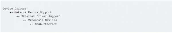

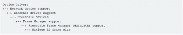

参考附图
1. L2 frame size, 9600
2. Enable, FSL_DPAA_ETH_JUMBO_FRAME - "Optimize for jumbo frames"
