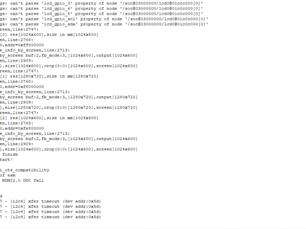

启动时报以下错误,不能进冒号.是不是要关闭某个驱动sunxi_i2c_do_xfer()1947 - [i2c4] xfer timeout (dev addr:0x5d)

tanglu 发表于 2022-4-9 14:25:29 | 显示全部楼层
您方便把您启机的打印信息发过来吗?我给您看一下。
打印信息已更新  详情 回复 发表于 2022-4-11 16:51

楼主| generalj 发表于 2022-4-11 16:51:15 | 显示全部楼层
打印信息已更新

tanglu 发表于 2022-4-13 09:05:44 | 显示全部楼层
您现在烧录的是用户资料里边的镜像还是您编译打包生成的镜像?从打印信息来看,您现在接的是hdmi屏做显示吗?您在uboot阶段有选屏吗?

楼主| generalj 发表于 2022-4-14 09:53:58 | 显示全部楼层
烧写的是自己修改过的镜像,不过只修改了串口和SPI的配置.
我是不接屏使用.
还有,这块核心板是返修板,加密芯片已根据后面升级的版本升了级的,下载的是最新的镜像.不知道跟这个有没有关系.
其他几块核心板同样的镜像,没有这个问题.
刚才试了一个超时久才启动:

[    5.131581] <<-GTP-INFO->> GTP driver installing...
[    5.137556] <<-GTP-INFO->> GTP Driver Version: V2.4<2014/11/28>
[    5.144296] <<-GTP-INFO->> GTP I2C Address: 0x5d
[    5.149647] of_get_named_gpiod_flags: parsed 'goodix,irq-gpio' property of node '/soc@03000000/twi@0x05003000/gt911_ts@5d[0]' - status (0)
[    5.163743] of_get_named_gpiod_flags: parsed 'goodix,rst-gpio' property of node '/soc@03000000/twi@0x05003000/gt911_ts@5d[0]' - status (0)
[    5.177878] 4-005d supply vdd_ana not found, using dummy regulator
[    5.185025] 4-005d supply vcc_i2c not found, using dummy regulator
[    5.192213] <<-GTP-INFO->> Guitar reset
[    5.555195] hdmi_hpd_sys_config_release
[   10.428530] sunxi_i2c_do_xfer()1947 - [i2c4] xfer timeout (dev addr:0x5d)
[   15.548529] sunxi_i2c_do_xfer()1947 - [i2c4] xfer timeout (dev addr:0x5d)
[   20.668541] sunxi_i2c_do_xfer()1947 - [i2c4] xfer timeout (dev addr:0x5d)
[   25.788532] sunxi_i2c_do_xfer()1947 - [i2c4] xfer timeout (dev addr:0x5d)
[   30.908541] sunxi_i2c_do_xfer()1947 - [i2c4] xfer timeout (dev addr:0x5d)
[   30.916221] <<-GTP-ERROR->> I2C Write: 0x8041, 1 bytes failed, errcode: -62!
[   36.028535] sunxi_i2c_do_xfer()1947 - [i2c4] xfer timeout (dev addr:0x5d)
[   41.148533] sunxi_i2c_do_xfer()1947 - [i2c4] xfer timeout (dev addr:0x5d)
[   46.268554] sunxi_i2c_do_xfer()1947 - [i2c4] xfer timeout (dev addr:0x5d)
[   51.388540] sunxi_i2c_do_xfer()1947 - [i2c4] xfer timeout (dev addr:0x5d)
[   56.511856] sunxi_i2c_do_xfer()1947 - [i2c4] xfer timeout (dev addr:0x5d)
[   56.519544] <<-GTP-ERROR->> I2C Read: 0x8047, 1 bytes failed, errcode: -62! Process reset.
[   56.528869] <<-GTP-INFO->> Guitar reset
[   61.841860] sunxi_i2c_do_xfer()1947 - [i2c4] xfer timeout (dev addr:0x5d)
[   66.965198] sunxi_i2c_do_xfer()1947 - [i2c4] xfer timeout (dev addr:0x5d)
[   72.081863] sunxi_i2c_do_xfer()1947 - [i2c4] xfer timeout (dev addr:0x5d)
[   77.201854] sunxi_i2c_do_xfer()1947 - [i2c4] xfer timeout (dev addr:0x5d)
[   82.321861] sunxi_i2c_do_xfer()1947 - [i2c4] xfer timeout (dev addr:0x5d)
[   82.329537] <<-GTP-ERROR->> I2C Write: 0x8041, 1 bytes failed, errcode: -62!
[   82.337505] <<-GTP-ERROR->> GTP i2c test failed time 1.
[   87.441856] sunxi_i2c_do_xfer()1947 - [i2c4] xfer timeout (dev addr:0x5d)
[   92.561848] sunxi_i2c_do_xfer()1947 - [i2c4] xfer timeout (dev addr:0x5d)
[   97.681849] sunxi_i2c_do_xfer()1947 - [i2c4] xfer timeout (dev addr:0x5d)
[  102.801851] sunxi_i2c_do_xfer()1947 - [i2c4] xfer timeout (dev addr:0x5d)
[  107.419429] random: crng init done
[  107.921850] sunxi_i2c_do_xfer()1947 - [i2c4] xfer timeout (dev addr:0x5d)
[  107.929546] <<-GTP-ERROR->> I2C Read: 0x8047, 1 bytes failed, errcode: -62! Process reset.

1、您那儿是有好几个核心板,烧相同的镜像,只有这一块儿核心板启动异常吗? 2、您这块儿核心板登录后的账户信息是root@forlinx:/还是#,如果是升级了加密芯片的资料,账户信息是root@forlinx:/才对,您这块儿是怎  详情 回复 发表于 2022-4-15 15:56

肉肉珩 发表于 2022-4-15 15:56:17 | 显示全部楼层
我是不接屏使用.
2、您这块儿核心板登录后的账户信息是root@forlinx:/还是#,如果是升级了加密芯片的资料,账户信息是root@forlinx:/才对,您这块儿是怎么适配的,是在最新的SDK里做的配置吗?
3、如果是升级过加密芯片的,烧一个出厂镜像试试,还有这个问题吗?可以确定一下是核心板本身问题,还是修改的问题;
4、正常情况下镜像烧写完第一次启动时间会比较长,之后就不会了,您这个是第一次启动的信息吗?
1、您那儿是有好几个核心板,烧相同的镜像,只有这一块儿核心板启动异常吗? 这两天这个板又能启动了,没出现前面的情况. 只有这一块返修后更换了加密芯片,我手头没有其他相同的,要不就是原来旧版的,要不就是新发货  详情 回复 发表于 2022-4-18 14:39

楼主| generalj 发表于 2022-4-18 14:39:00 | 显示全部楼层
2、您这块儿核心板登录后的 ...
只有这一块返修后更换了加密芯片,我手头没有其他相同的,要不就是原来旧版的,要不就是新发货新版的.
还是#,我这个固件是你们技术支持发了个文件给我替换后,是用旧的源码编译的,即旧固件写到更换了加密芯片的板子上,如果不替换文件,旧板的固件无法烧录到新板子上.
有一块新版的板子,我也是烧写的这个固件,提示符也是#,从始至终没出现过类似问题.
烧写新版的出厂镜像,也没有问题.现在这个板暂时没出问题了,也不好对比查的原因了.
之前出故障时是会反复出现问题.
这个板能启动,但有GPU类的报错,是不是这个板子还是有问题?

[    4.803173] twi_stop()516 - [i2c4] STOP can't sendout!
[    4.808954] sunxi_i2c_core_process()1759 - [i2c4] STOP failed!
[    4.816810] twi_stop()516 - [i2c4] STOP can't sendout!
[    4.822589] sunxi_i2c_core_process()1759 - [i2c4] STOP failed!
[    4.830510] twi_stop()516 - [i2c4] STOP can't sendout!
[    4.836290] sunxi_i2c_core_process()1759 - [i2c4] STOP failed!
[    4.844110] twi_stop()516 - [i2c4] STOP can't sendout!
[    4.849889] sunxi_i2c_core_process()1759 - [i2c4] STOP failed!
[    4.856468] <<-GTP-ERROR->> I2C Read: 0x8047, 1 bytes failed, errcode: -70! Process reset.
[    4.865792] <<-GTP-INFO->> Guitar reset
[    4.966314] twi_stop()516 - [i2c4] STOP can't sendout!
[    4.972096] sunxi_i2c_core_process()1759 - [i2c4] STOP failed!
[    4.979917] twi_stop()516 - [i2c4] STOP can't sendout!
[    4.985698] sunxi_i2c_core_process()1759 - [i2c4] STOP failed!
[    4.993772] twi_stop()516 - [i2c4] STOP can't sendout!
[    4.999554] sunxi_i2c_core_process()1759 - [i2c4] STOP failed!
[    5.007564] twi_stop()516 - [i2c4] STOP can't sendout!
[    5.013345] sunxi_i2c_core_process()1759 - [i2c4] STOP failed!
[    5.021230] twi_stop()516 - [i2c4] STOP can't sendout!
[    5.027010] sunxi_i2c_core_process()1759 - [i2c4] STOP failed!
[    5.033758] <<-GTP-ERROR->> I2C Write: 0x8041, 1 bytes failed, errcode: -70!
[    5.041771] <<-GTP-ERROR->> GTP i2c test failed time 1.
[    5.062962] twi_stop()516 - [i2c4] STOP can't sendout!
[    5.068743] sunxi_i2c_core_process()1759 - [i2c4] STOP failed!
[    5.076617] twi_stop()516 - [i2c4] STOP can't sendout!
[    5.082397] sunxi_i2c_core_process()1759 - [i2c4] STOP failed!
[    5.090272] twi_stop()516 - [i2c4] STOP can't sendout!
[    5.096053] sunxi_i2c_core_process()1759 - [i2c4] STOP failed!
[    5.103939] twi_stop()516 - [i2c4] STOP can't sendout!
[    5.109719] sunxi_i2c_core_process()1759 - [i2c4] STOP failed!
[    5.117613] twi_stop()516 - [i2c4] STOP can't sendout!
[    5.123394] sunxi_i2c_core_process()1759 - [i2c4] STOP failed!
[    5.130052] <<-GTP-ERROR->> I2C Read: 0x8047, 1 bytes failed, errcode: -70! Process reset.
[    5.139419] <<-GTP-INFO->> Guitar reset
[    5.239665] twi_stop()516 - [i2c4] STOP can't sendout!
[    5.245448] sunxi_i2c_core_process()1759 - [i2c4] STOP failed!
[    5.253427] twi_stop()516 - [i2c4] STOP can't sendout!
[    5.259209] sunxi_i2c_core_process()1759 - [i2c4] STOP failed!
[    5.267045] twi_stop()516 - [i2c4] STOP can't sendout!
[    5.272825] sunxi_i2c_core_process()1759 - [i2c4] STOP failed!
[    5.280738] twi_stop()516 - [i2c4] STOP can't sendout!
[    5.286517] sunxi_i2c_core_process()1759 - [i2c4] STOP failed!
[    5.294470] twi_stop()516 - [i2c4] STOP can't sendout!
[    5.300249] sunxi_i2c_core_process()1759 - [i2c4] STOP failed!
[    5.306972] <<-GTP-ERROR->> I2C Write: 0x8041, 1 bytes failed, errcode: -70!
[    5.314978] <<-GTP-ERROR->> GTP i2c test failed time 2.
[    5.336322] twi_stop()516 - [i2c4] STOP can't sendout!
[    5.342106] sunxi_i2c_core_process()1759 - [i2c4] STOP failed!
[    5.349915] twi_stop()516 - [i2c4] STOP can't sendout!
[    5.355690] sunxi_i2c_core_process()1759 - [i2c4] STOP failed!
[    5.363561] twi_stop()516 - [i2c4] STOP can't sendout!
[    5.369339] sunxi_i2c_core_process()1759 - [i2c4] STOP failed!
[    5.377264] twi_stop()516 - [i2c4] STOP can't sendout!
[    5.383045] sunxi_i2c_core_process()1759 - [i2c4] STOP failed!
[    5.390859] twi_stop()516 - [i2c4] STOP can't sendout!
[    5.396640] sunxi_i2c_core_process()1759 - [i2c4] STOP failed!
[    5.403218] <<-GTP-ERROR->> I2C Read: 0x8047, 1 bytes failed, errcode: -70! Process reset.
[    5.412550] <<-GTP-INFO->> Guitar reset
[    5.512981] twi_stop()516 - [i2c4] STOP can't sendout!
[    5.518763] sunxi_i2c_core_process()1759 - [i2c4] STOP failed!
[    5.525385] hdmi_hpd_sys_config_release
[    5.526785] twi_stop()516 - [i2c4] STOP can't sendout!
[    5.526789] sunxi_i2c_core_process()1759 - [i2c4] STOP failed!
[    5.527033] twi_stop()526 - [i2c4] i2c state(0x0) isn't idle(0xf8)
[    5.527036] sunxi_i2c_core_process()1759 - [i2c4] STOP failed!
[    5.527145] twi_start()482 - [i2c4] START can't sendout!
[    5.527150] sunxi_i2c_do_xfer()1931 - [i2c4] twi_regulator:
[    5.528508] twi_stop()516 - [i2c4] STOP can't sendout!
[    5.528511] sunxi_i2c_core_process()1759 - [i2c4] STOP failed!
[    5.528744] twi_stop()526 - [i2c4] i2c state(0x0) isn't idle(0xf8)
[    5.528748] sunxi_i2c_core_process()1759 - [i2c4] STOP failed!
[    5.528856] twi_start()482 - [i2c4] START can't sendout!
[    5.528860] sunxi_i2c_do_xfer()1931 - [i2c4] twi_regulator:
[    5.530219] twi_stop()516 - [i2c4] STOP can't sendout!
[    5.530222] sunxi_i2c_core_process()1759 - [i2c4] STOP failed!
[    5.530454] twi_stop()526 - [i2c4] i2c state(0x0) isn't idle(0xf8)
[    5.530457] sunxi_i2c_core_process()1759 - [i2c4] STOP failed!
[    5.530565] twi_start()482 - [i2c4] START can't sendout!
[    5.530570] sunxi_i2c_do_xfer()1931 - [i2c4] twi_regulator:
[    5.531932] twi_stop()516 - [i2c4] STOP can't sendout!
[    5.531935] sunxi_i2c_core_process()1759 - [i2c4] STOP failed!
[    5.531960] <<-GTP-ERROR->> I2C Write: 0x8041, 1 bytes failed, errcode: -70!
[    5.531965] <<-GTP-ERROR->> GTP i2c test failed time 3.
[    5.553002] twi_stop()516 - [i2c4] STOP can't sendout!
[    5.553007] sunxi_i2c_core_process()1759 - [i2c4] STOP failed!
[    5.553243] twi_stop()526 - [i2c4] i2c state(0x0) isn't idle(0xf8)
[    5.553246] sunxi_i2c_core_process()1759 - [i2c4] STOP failed!
[    5.553359] twi_start()482 - [i2c4] START can't sendout!
[    5.553364] sunxi_i2c_do_xfer()1931 - [i2c4] twi_regulator:
[    5.554721] twi_stop()516 - [i2c4] STOP can't sendout!
[    5.554724] sunxi_i2c_core_process()1759 - [i2c4] STOP failed!
[    5.554956] twi_stop()526 - [i2c4] i2c state(0x0) isn't idle(0xf8)
[    5.554958] sunxi_i2c_core_process()1759 - [i2c4] STOP failed!
[    5.555086] twi_start()482 - [i2c4] START can't sendout!
[    5.555091] sunxi_i2c_do_xfer()1931 - [i2c4] twi_regulator:
[    5.556446] twi_stop()516 - [i2c4] STOP can't sendout!
[    5.556449] sunxi_i2c_core_process()1759 - [i2c4] STOP failed!
[    5.556682] twi_stop()526 - [i2c4] i2c state(0x0) isn't idle(0xf8)
[    5.556685] sunxi_i2c_core_process()1759 - [i2c4] STOP failed!
[    5.556793] twi_start()482 - [i2c4] START can't sendout!
[    5.556797] sunxi_i2c_do_xfer()1931 - [i2c4] twi_regulator:
[    5.558154] twi_stop()516 - [i2c4] STOP can't sendout!
[    5.558157] sunxi_i2c_core_process()1759 - [i2c4] STOP failed!
[    5.558389] twi_stop()526 - [i2c4] i2c state(0x0) isn't idle(0xf8)
[    5.558392] sunxi_i2c_core_process()1759 - [i2c4] STOP failed!
[    5.558514] twi_start()482 - [i2c4] START can't sendout!
[    5.558518] sunxi_i2c_do_xfer()1931 - [i2c4] twi_regulator:
[    5.559878] twi_stop()516 - [i2c4] STOP can't sendout!
[    5.559880] sunxi_i2c_core_process()1759 - [i2c4] STOP failed!
[    5.559899] <<-GTP-ERROR->> I2C Read: 0x8047, 1 bytes failed, errcode: -70! Process reset.
[    5.559902] <<-GTP-INFO->> Guitar reset
[    5.659653] twi_stop()516 - [i2c4] STOP can't sendout!
[    5.659657] sunxi_i2c_core_process()1759 - [i2c4] STOP failed!
[    5.659896] twi_stop()526 - [i2c4] i2c state(0x0) isn't idle(0xf8)
[    5.659898] sunxi_i2c_core_process()1759 - [i2c4] STOP failed!
[    5.660008] twi_start()482 - [i2c4] START can't sendout!
[    5.660013] sunxi_i2c_do_xfer()1931 - [i2c4] twi_regulator:
[    5.661369] twi_stop()516 - [i2c4] STOP can't sendout!
[    5.661372] sunxi_i2c_core_process()1759 - [i2c4] STOP failed!
[    5.661605] twi_stop()526 - [i2c4] i2c state(0x0) isn't idle(0xf8)
[    5.661607] sunxi_i2c_core_process()1759 - [i2c4] STOP failed!
[    5.661746] twi_start()482 - [i2c4] START can't sendout!
[    5.661750] sunxi_i2c_do_xfer()1931 - [i2c4] twi_regulator:
[    5.663110] twi_stop()516 - [i2c4] STOP can't sendout!
[    5.663114] sunxi_i2c_core_process()1759 - [i2c4] STOP failed!
[    5.663351] twi_stop()526 - [i2c4] i2c state(0x0) isn't idle(0xf8)
[    5.663354] sunxi_i2c_core_process()1759 - [i2c4] STOP failed!
[    5.663463] twi_start()482 - [i2c4] START can't sendout!
[    5.663468] sunxi_i2c_do_xfer()1931 - [i2c4] twi_regulator:
[    5.664824] twi_stop()516 - [i2c4] STOP can't sendout!
[    5.664827] sunxi_i2c_core_process()1759 - [i2c4] STOP failed!
[    5.665060] twi_stop()526 - [i2c4] i2c state(0x0) isn't idle(0xf8)
[    5.665063] sunxi_i2c_core_process()1759 - [i2c4] STOP failed!
[    5.665189] twi_start()482 - [i2c4] START can't sendout!
[    5.665193] sunxi_i2c_do_xfer()1931 - [i2c4] twi_regulator:
[    5.666551] twi_stop()516 - [i2c4] STOP can't sendout!
[    5.666554] sunxi_i2c_core_process()1759 - [i2c4] STOP failed!
[    5.666573] <<-GTP-ERROR->> I2C Write: 0x8041, 1 bytes failed, errcode: -70!
[    5.666578] <<-GTP-ERROR->> GTP i2c test failed time 4.
[    5.686326] twi_stop()516 - [i2c4] STOP can't sendout!
[    5.686330] sunxi_i2c_core_process()1759 - [i2c4] STOP failed!
[    5.686572] twi_stop()526 - [i2c4] i2c state(0x0) isn't idle(0xf8)
[    5.686575] sunxi_i2c_core_process()1759 - [i2c4] STOP failed!
[    5.686684] twi_start()482 - [i2c4] START can't sendout!
[    5.686688] sunxi_i2c_do_xfer()1931 - [i2c4] twi_regulator:
[    5.688043] twi_stop()516 - [i2c4] STOP can't sendout!
[    5.688046] sunxi_i2c_core_process()1759 - [i2c4] STOP failed!
[    5.688280] twi_stop()526 - [i2c4] i2c state(0x0) isn't idle(0xf8)
[    5.688283] sunxi_i2c_core_process()1759 - [i2c4] STOP failed!
[    5.688412] twi_start()482 - [i2c4] START can't sendout!
[    5.688417] sunxi_i2c_do_xfer()1931 - [i2c4] twi_regulator:
[    5.689777] twi_stop()516 - [i2c4] STOP can't sendout!
[    5.689780] sunxi_i2c_core_process()1759 - [i2c4] STOP failed!
[    5.690017] twi_stop()526 - [i2c4] i2c state(0x0) isn't idle(0xf8)
[    5.690019] sunxi_i2c_core_process()1759 - [i2c4] STOP failed!
[    5.690124] twi_start()482 - [i2c4] START can't sendout!
[    5.690129] sunxi_i2c_do_xfer()1931 - [i2c4] twi_regulator:
[    5.691482] twi_stop()516 - [i2c4] STOP can't sendout!
[    5.691485] sunxi_i2c_core_process()1759 - [i2c4] STOP failed!
[    5.691719] twi_stop()526 - [i2c4] i2c state(0x0) isn't idle(0xf8)
[    5.691722] sunxi_i2c_core_process()1759 - [i2c4] STOP failed!
[    5.691843] twi_start()482 - [i2c4] START can't sendout!
[    5.691847] sunxi_i2c_do_xfer()1931 - [i2c4] twi_regulator:
[    5.693209] twi_stop()516 - [i2c4] STOP can't sendout!
[    5.693212] sunxi_i2c_core_process()1759 - [i2c4] STOP failed!
[    5.693235] <<-GTP-ERROR->> I2C Read: 0x8047, 1 bytes failed, errcode: -70! Process reset.
[    5.693238] <<-GTP-INFO->> Guitar reset
[    5.792992] twi_stop()516 - [i2c4] STOP can't sendout!
[    5.792997] sunxi_i2c_core_process()1759 - [i2c4] STOP failed!
[    5.793234] twi_stop()526 - [i2c4] i2c state(0x0) isn't idle(0xf8)
[    5.793237] sunxi_i2c_core_process()1759 - [i2c4] STOP failed!
[    5.793346] twi_start()482 - [i2c4] START can't sendout!
[    5.793351] sunxi_i2c_do_xfer()1931 - [i2c4] twi_regulator:
[    5.794711] twi_stop()516 - [i2c4] STOP can't sendout!
[    5.794714] sunxi_i2c_core_process()1759 - [i2c4] STOP failed!
[    5.794953] twi_stop()526 - [i2c4] i2c state(0x0) isn't idle(0xf8)
[    5.794955] sunxi_i2c_core_process()1759 - [i2c4] STOP failed!
[    5.795086] twi_start()482 - [i2c4] START can't sendout!
[    5.795091] sunxi_i2c_do_xfer()1931 - [i2c4] twi_regulator:
[    5.796449] twi_stop()516 - [i2c4] STOP can't sendout!
[    5.796451] sunxi_i2c_core_process()1759 - [i2c4] STOP failed!
[    5.796684] twi_stop()526 - [i2c4] i2c state(0x0) isn't idle(0xf8)
[    5.796687] sunxi_i2c_core_process()1759 - [i2c4] STOP failed!
[    5.796796] twi_start()482 - [i2c4] START can't sendout!
[    5.796800] sunxi_i2c_do_xfer()1931 - [i2c4] twi_regulator:
[    5.798157] twi_stop()516 - [i2c4] STOP can't sendout!
[    5.798160] sunxi_i2c_core_process()1759 - [i2c4] STOP failed!
[    5.798392] twi_stop()526 - [i2c4] i2c state(0x0) isn't idle(0xf8)
[    5.798395] sunxi_i2c_core_process()1759 - [i2c4] STOP failed!
[    5.798527] twi_start()482 - [i2c4] START can't sendout!
[    5.798531] sunxi_i2c_do_xfer()1931 - [i2c4] twi_regulator:
[    5.799884] twi_stop()516 - [i2c4] STOP can't sendout!
[    5.799886] sunxi_i2c_core_process()1759 - [i2c4] STOP failed!
[    5.799905] <<-GTP-ERROR->> I2C Write: 0x8041, 1 bytes failed, errcode: -70!
[    5.799910] <<-GTP-ERROR->> GTP i2c test failed time 5.
[    5.818391] <<-GTP-ERROR->> I2C communication ERROR!
[    5.818603] <<-GTP-INFO-928->> GTP driver installing...
[    5.819653] axp2101_pek: Setting power key for unsupported AXP variant
[    5.823326] input: axp2101-pek as /devices/platform/soc/twi5/i2c-5/5-0036/axp2101-pek.0/input/input1
[    5.824002] sunxi_gpadc_init,1540, success
[    5.824764] sunxi_gpadc_setup: get channel compare select failed
[    5.824770] sunxi_gpadc_setup: get channel compare low data select failed
[    5.824774] sunxi_gpadc_setup: get channel compare hig data select failed
[    5.824781] sunxi_gpadc_setup:get channel0_compare_lowdata err!
