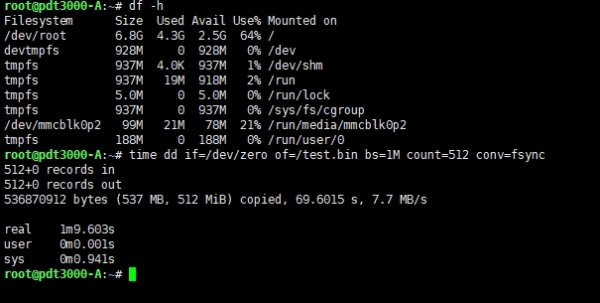

hai 发表于 2023-3-28 11:10:28 | 显示全部楼层
您这样测试不是很准确,没有同步到emmc中。您试试这个命令测试一下:time dd if=/dev/zero of=/test.bin bs=1M count=512 conv=fsync

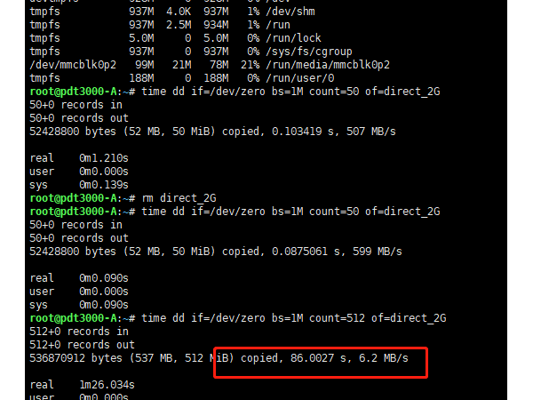

楼主| 张宝强 发表于 2023-9-27 11:06:52 | 显示全部楼层
您这样测试不是很准确,没有同步到emmc中。您试试这个命令测试一下:time dd if=/dev/zero of=/test.bin bs ...
[img][/img]**9pd5FzSZ+g3pZwzwWTPJ51f5rF7Fznz/lvvI1yf/PlEfIgErWo7ys/y1AjCJ/PzGIoeH7rPuqDfNdzJ9/G70w7k7VvHA56DboCBkwZBYdCF4aoSIPllLg0bGy1t4OJ9Nr7BVW4ZUzSQbp/m33LxLU1XDgYZJd1H8qC/3ov1HKktxaBG9zTB5Xbe8Vrg0MtNXgqeVhH1u5ecHfos5YzEgIkaEU9eJ3MvORf1Htova29fN/Lsnd05egT9+V1J7oW+V8UBlWX0ZWFHPIaTLiIBWrIhi3VckBfvg0ABA8BAiYHccBQGXRiuKgGSC5wtw1ghQHIwp/VAhdu8FBYNuEInRVvKd3U7WW0kByl+V7/H93e+NmWPZaVnHiRnKk/Utbgn+kvCN+vsQXKmcr2cBvkR8tOzifhaGFDPhrwrJCeVBwKUt0FuY5EGfQADh8FALggZ9KtciyMMep0A8dTEeTam0nBahpW+QAe1Q+UBnoV3Bt5lGBzv9KK1OmnnHa3vELrmnUnSIxDaPU7VcNs9ZcAOeCyIBQ3U1foZ5JlJB9dlw7VansirkNNjXU7tBg9QNlUn3q+u05LPbP4diIpsZwv/qwmQhYskY40cySmzYCfSB4+wMV6+Zv65vbLqg3vQETAADHRiQCuKFrtyvBjeBRbm7qsESOzgmCR5YqNoESC/iFLuFKGytCz4u7MRg2dMT9kkfZ7dRe7KuU5uEtujT359jfHVbg1EOxCLZp0of949FK9psXatfveSs1Ye4bol54XWTHEfCnGA/Pqae8nJ/UxfDRmv0lvLz6d6VtaG8XPxmuyAuh/atUaATs6TbN+mcTchT3uBAMGzbWIJ9r9pK6GzPfrNjSDTxguNskejIA/g6JgYQH8/Zrugv6BdgIEtGAABAsu+EQPoeFs6Ht4BboABYAAYeC4Gbhz88EUIAD8XwNA/9A8MAAPAADCwBQM3EiAofYvS8Q5wAwwAA8AAMAAMPBcDIECYAgMGgAFgABgABoCBj8PAYyqc7QBJu5MeUzZADT0DA++Hgdmm0DmFIsr0LV+UmNKHR+IW/ODdV8NPbhiLuCa7NCjFABHHZeySZy43BjjafjxvvQ5byY2t7abuKVZNOOQ2iwYct1GnbejxOIpHRIJe356VOpj17cHOu+izohca6OOW9Ll9e/Sinnk0YbDKs8ILbG13K/+teeG9VxsMIe/nYTY3aHchQN7YggCtH9Tztmm/X4+/0n6PIwHHoJQUE4bPeOI4MhygkoIrTsc8qDIE8zPqsLlDv4c+bb0EcueJz40Dfsj/cef5meWBAGHg3tzP19hYPLs0lrxgemxUHuyyIHQcCHEKgd3ofKnoKUjRZaMBTfezQIjtr2g6/iJ8hZILW5wMDzBvM>**B+zSO5dIsB9YRjdOgbxexhjAjgnRYdqpUYfNMr6DPmt6uXhv4e0EqMw/RBmngIqybw/urImWJC3KhpAXcjCnya3y1MGqsr1TgEcKRqmnyBqesTSdFuxXsnUyb/zeYKNAIF6QILx7O+egTIMfd3AyTn76ShgDbbyu247CoHyToaMDOgsjlcsG8LT0EdpnjqIcDrpc1JkemKjdqX2J5MR2vgyUF0UIHxwdsXG4KbBWHRjHq69voM+WXny/pinTeCAqHZcy9UWCZkwVtsLrOOotkYiIWS1L1YbEiNEGybbLqxGgIAcd9kqkTHuOMs8YpfNRMUlOen9yID8tm4M07gu4viwWcsELI5MMQpgqKb4avSEV01vWAKmfIUPp78kzk3I5AKgb9UEnfHtiupAPty+3B315cxvyIOWfiYMBp60mFAty3JJfqw635CvffUV9dujlzMSHToWX9V38TfiyPDVMPFR7syycL2OL/qY0uUZQpvHzteNaKN163sqTSZVOS2XwyfTk9QxHmMAOqXaUusLvd/eOfEL9coBvIkDya6/HGMWOw8aXF2MmbxA61j7Ao7Zgo1/TqR6Y6Dl+L7WlGNQ4rZbfM+636rCnPD11b8nyaH22ZPHTQ9H7Q+TOL6Dv9BpKjBT6DZ6Toi9rWZIumHSIKSqZxvm3dG89v6Y8LoOu9N6VyA9tChAfdvIZ/N7HPkGP0OPzMbADAZKGwjJU3qi0jQmtB9ptK+vzlXoMYFttUeimXFeRSLA1sHTlmWPq/l/RjToU9b1Btq66N2R5uD4bsgi9pOmhjn4a2rJCcnyelbQ1hKTQUyVPrkPxPBMZYXNk27XqKeQkvSx+QLAMuB7D5qEd0A7rMJAPCDT4XeVaHGUQ7CmwbWuARp539yfDH3N30f0H71z/m8ujqQyhz5M1ZeMNP7VVXma2HkLvApPePQKWHEjWAe2uHbNah60yvok+e/QSnjmXU1E13VmEIz1bIytExnjKLKzJSR88wsZ4/Ov89d+prIhjj2tBdnw6yVG3S5lezDVAlDfJXPaXzX1Uy42/72oT0E65nYc+TH3om+wOpwWSvAssuKfJaJgEaBrm3WGSPHEHNw0ULXaUO0WoLC0L/u4HLS3knOZddXFxa/Z+hQD5nTu1OEAvQoCqdWAMrr6+iz4ru52kPtJuqb5F0MkOyDzS7xoBioubY+yhQXp8FwhQu7xgI2iHYtgAIIhQqtfWXWCR8CfiBnuU2ZPU5tAL9PKyGLhRcG280CnwVQMMvC8GHt3fH10esPu+2EXbom1LDIAAgb3fiIESVOho0AkwAAwAA8DA0TFw4+CHL7SjNzDkgxECBoABYAAYAAZKDNxIgMoMoWToBBgABoABYAAYAAaOjgEQIEyBAQPAADAADAADwMDHYeAxFfbb63kHCHZ7HZ0VQz58ub0UBmBfHmPHQRCg5zfDQN6gKQjergNAGZDtzZR4jMFCbPv1ZzwN8yndIeo2hTaI5z9xGsVYyQ7Ajc/wWWBZHJQQF+WYweE6tnuvxfRb6LOiF1q7x1hQcaFW9c1HrwE0y7vRvph55nZxlU7W4gzPH8N+oh0+sR3yjn4XAuSNrYjPAaDdAWgctC2SHjpcduLAc+Gg2RRnyafVAryJOC5Mjvg4jcvopumYASuzwHZEXG6O3fIe+rT1wkECjWMoVvbNkP9MtO9NFMzybrQvZp4r9XDveiP/fJyCPqCPnTAQFcmDXeYN4ECIk5vorKBpnAMesgchfj0NMRDZlAVCDIY29zDwoFwGQizOD4IR6idK1lcsERZuJ6XLKtGVUXf9bzoYMpBXCjbnA9gxIVJ57gTI/jqn8ksPQLV+6Z0FA/IW+qzphcixEdS0VzfpOSv/PLjp3Kfp2bnve6wIrOmgqPN7sp10eXvYF50nlVfxmlG9PdmKXtRRH98TPh7GLMBrPONMeBMzG6lxJnTiy1oKMpvaQuoJv59ni6D7F9N93mDFwOE7PA2Awdj4AVV3Uj9NQl+BIcR9MeimPERZ8V4ydOSVyMiTeBadfJkUaENKOqN2sshKPPxSH4nhDT8PjPz+NPgI0+OFIoQP7lzL85lttKbuvXKuyfOo+mzVgdLSFNjZ8cHEY4UwW0atZitqfVp7WujvFFn+Orrae1x2UR63pa+L8jDHe1vyDHJe3NnnTxHB59/6eI10nEd8ltLze2THgu0cL4aN1G201rayDnBdtpHQEXRUYiAnGoWRER00M1h8RII2PtYAqZ8hIfy9yQ3eKOQysMHDdY1e6EuWBhQ5BSYPc5Rfy5UjD3Q7sTGm+9MUvElW+5agemxH8/IN7syYokX2N8v5Bvrs0EsiPpdzHPB7MUf6UR4d1j9jUOOC8eTvC8/L0nvpeVUe5+/ftwjQkn2p1UHlVSsnqw/pjYmO0qGWT2KT0tiWUjkyz9Z7LBOuj7U10Pe76TvvrJsIUK0DM1h0R4732fjyl2j6WuP3cF0HNuFm99OVdN5SxQNEX6raU6e/0GdjLAy7NN5HaR89iJBce8j56vps6cXXbfKE+Rw9WH7hfI286Lau6Lfdp2fCQXZGYrP93kJ7brUvVh0snXHddRq9L22fJ0AGSWu9tzWNZcJ1nY2EvqCvHAM7ECA6NJUzrRkV+Qw/K660BiA3Jrlc8Aat10dBZoW+C4JAhli3UWHgFwYimf9DfwtvQiy3WfeNsjXz1Lg/hD779JKIryWzqSsixMZAr561+nTQoViDpN6hfl6+t1Beh9zdebby0mlF/6jIab3HHyaUJkmUzLP1nqE32Mj1NhI6+3id5QogA3WVa3FEB61PgfHUy7o1QGOaW48nRbNRQOfexNIvw+B4pxet1UmE5jI4qWt21UsPUGj3S16uNMbcJnqg5/tPvoZBPK7VIO+Gnp7ZIN876LNHL6sJkIUL0i/pfalP+0GdFhGLj6al92rlcZtqotAjSyPPTGe0rjHViT2h81qe/KOtQoDS1Nj83tz3Zq8Y9UsqO+UZdWWuHeK645rbLOgD+liHgZwAnU602DXGgiEj1UOAlnYqWAYqfumF6a+ww4wHb7By3Sadf/tpjdh2tGMvBZwkIy5251wnN428sJPylkZYlGUNEnTvkES1sXNnXYeYDchb6LNDL6melbVhSn80SJcL6ANuyNPS7tOBRGgMtd5rledtxQb70s6zobNISvx0YWUX2NzvRF9KOr66bBeYt4NTis/ld1myRyjaXnuHrchbtQ/sJ3QDDHRjoPvBeWCQHS520rBj4sa8ZL74besbeoFenomBm/s7e1E6bcXN5Rnl7JXnvT8G9pLzmXhB2bBXx8aAYSDWCIxOCoCvwQue/Wy8kL2Q018vhgfyVAUPT2W6f8/6wLZ+dl/ZE0vIq4YlECC4C2/EADpXrXPhvsCGX99ypZ1nr4y3OIV3LaeydrcjIEDoP6L/7I4v5E34emVjBNnRfsAAMAAMAAPAADCwCQObXgIzB3EEBoABYAAYAAaAgVfGwAYCZO0OOjoIGu5kvwWcz0DjHRhcn8Z7YNwbsMN6xfWVjcZ7yW7as5WLtR+N54Zdgj2DXcLY1I2ByoONDjZHCK68u8UYtMrbkp9+pyd/yxAuvtfYMqtlEH+3tv3eBbxiG67fwivPfKqlkT788RrczrRdXh6vwff3u7b0Ig37HEclBmd8pJxRL/khv0IvmT5prUiMr3QnfW7SGeE6nQV2Q/st9o8b8hb9JfWJe5Rn9Xur7DX37iGnLL8nf6tei++9iD2TusDv9/ogeWx72gaKFixmg4wUyupYMn3D72Z5G/JLBpPfXez4cSBd6QEKcq8MwEcDpIjD4wd2XS7Lvcs1EJf8nDCO5NtIiwN2itlCwRWn/AiDQs+3yNupF9JXhs1Hy1nUkbwFrE/2HMQz2VIQvJmo7arPTTpjGeOZfDdg7+79Vun6LuXBnqUB9DXsmT1m7WqLFO6Q99vq3KoYDYoiUiuBgQgEfzFaAcDGOZjXfKI05cMDQyyHjA1/ESeQifI8UZnc5E9VHl0KAkYei1ZayqvyBRMJUMpPRrvmdy1DGN/jk6HzM7SE3DGPNDj3lMfl+kCESt8pzWqflfeyOszt4ElEK83rY3TjFGS7jJPzgdqK9lspT3fdSv2SIUo65nyeLWeGm1LmJO9D5CzLL3W2FwGyygpkcMwCIsaDaiXRkjpTfYU8lGYwQdlP/DsVO8G4IPJp2qW2PaP2Yu+e3rFGBIHTUsTmVB73A6GXlpyttJSnqgOf1aZ0poMr+gFb6pjzi++9tD3juuCaiCsIGve91dfyhWSwE8DYYM6h3GXnz78aQiRpNhyUxr+pkfTfhXGmDurJVyjTD9LckVtpUdZMFhnG3r+7cGQHl5PqLb+Qg2HPPA+ZMYl6pDyIIPSUx+VY5XLaHtclOeXAROVxHaJcl4G2LlO7Do6O2CgJbImhXTpkRS8FPp8qJ/cN1gH/XfEATYO7qz57dRbxyQeg8mGk88cL16d+LdrBYzXUX9oHjwWNQSln1lfqx+Jk5fl3iJiH8jI7EftMZgviga/BFsk2UsdPpP7Gz7Trb/WFbjnX1gH2DAN+wmcdl7vY3s8pRyuSvl7UF1jqqPHZwnjl3ovMANCzyWMgvoySglV5VFYckBNZ4nt8lURK3AukI5clgYGek16tTC6jXiyfz5+8IGItR5YWv25ZZ5xvT3k+H6p/ThKTzFzOzVcuIw7K53AYZWiXRhq3s9dBnHbi+t0sk8ad/pvl0vdrHiD2MjxYTt3OpJd0unrwFkyDWANE2L6bPlfoLLZfIj6Xs1sXzZ3KUnbC51khDr7Ow1wGY8vry+ibmpTr41pEfoWdsPKUnkPdZlKWqBc+L09+vBX90nxP6aUlZyutUockg1WHZGff3Z6VNiHpJbUfnoFOujCgHrIGONFRvVJlx/cdUbiFeTdV6oxkECIpsfLW90RZhWFrpbHBKAxnrJ94t6gDdxpZL74X6zd5V7oiVzpPeofro9OsvOXXK5d3r6tcmEvnhA2CmNbSksxiUOP63UtOn28oL/O2ifIygk33nyZn8GjmcsYBkKcq/DRMXE93VzlX6sy3OXn2zu6cCFv4u8twVnFAchjEqNUfWmnc7ro88U5hJ+gdSmdbJK/snZV2IrWLtIUC8yyDJ1HirDPKV+bDWEy2T3qQhfebZedr64NO58+yiHc/0p6xHnCFV+w2DOhOXzFeTGKoMGkwdEc0hAkGKria8y8qw1iK/ArD1kqjcildyill0WnaoOp68buqzNmbRXoT5C4+nwbnxfLaA1bXIMQybrgmOY13U5psZ37O0hun7XJd1kuSj8t7ipwVvAm8pDZknd1Nzg06Y93FwdeTOI1Z8Uyqi79n9Nv0bCVN60XqopVWK0+8U9gJekek57Ib7SZlyeqhPLOU55WPwlB2cIucQsZqHWDPMMAnTMqxGr+Lfr1NT0KRpiGg9GBgwy6ics6cOq/8CqZ1IoMMd0/5juPsCWJBrfJaRqGVFvMMsvBJ53QK+rxDi74IZR2kzF6Z0cBdWD66ijID4cmNYlYefVXztIDPq1ZeGCSK8mW5O/++DIO7xNPhqX0kUaymWe3j2zJO6ewsY8CZ2uFllHEUAkRy5ISYB9fJDcoD5J+7iz77sFToTOg19V8L/+K5ZHCseqTnKgQom8JSNiTrYwaxsMoT75D8/sNK3CNZU72ibLNdatuzUE9+RthH1o/vR6oOVMZaOYW87TrAniXsJZyJdsE9kMTtGJiBlDqhlZnv/DTVNbmxuQssrJXJ1xOQp0TESYn5m+W1jEIrLcl8w64JbzR5B0ic7hJl+k5IRo5Jji9zQ3k+Dz1tqKbXUn3m9rnJCOhprkiGfJ61NMug0z3p4t9TziW9GOl+4Hu0nL7OcapL6pF1caF1bHP7Uhwg3x/uIaehk6v0GhjpuRc2kDZa4+b7towPxfVRV7PfpmdqBCgubvbTUXE3IU/vWH2M0+T0UCoj/zBJ8uh8/PQj92dll+jZKEtuz6Kt8mlzG7LOaCdk2AWm6rBFTiFvXx3EFGV8l3e5mbvA3tmeSSzgNwjQdgzEAVZ0xpsG2l5BHl1er1x7Pffu9dtLT8jntYzXo3H96PK24vFV5ET9Xqu/bW0vvNfbzjt5GKDwXOHvbhDR3nl7Qx/QxztjAPYM+H5PfIMA3cXjBYMBg/GeBgPt+ontCnsG3L8n7kGA7kKA3hMsMAJoV2AAGAAGgIF3wQAIEAgQMAAMAAPAADAADHwcBh5TYb9lmHeAWDtnwKjfhVGjHsAyMAAMAAPAwCtgICdArXgh29lxGTBwe165vMhn1sdMMvO4TF5Hcqv7VR3rUUuLW6h5CzDHQbrbNvibDEYlHMENeb6HPit6oTUdvA1cxuxaq69Hrw15dHktfRSyVHTdygNprzBIQsb3xek8gNJAeRcC5I3tnePcvG8Dre58ZRtyUDfjgM4syCVhgZ+Ngd1okOS4PxRAcTKC/x1A9xRHhc7c8vF2iNBlsZpyjK8lza+sT1svoo2LQXydrkL+jKt1765tB3r+0eW1ZNSy2Lq+v05aMiIN+gcGmhiIiUbANB9QzRvIKQR2ozOkYiCwFMU4GtB0fxQHHsbBNAQO46Bi81Eb50Gcq0N5Y2psNdmxwF0O2KUHbn6mkUaYmOgg2EBeKQhcdobYAYhPqH+jDjvIOOuKO1KrvEbaw/VZkyUchus9ezcRoDJ/juY9Zn2bD4AVtsHrIv6tbEgeaJR1TldVnpZd5qnP7Srsi/LWZAEgQzDHog4ZlpQsWrZ7fUxmMkjd4LdlC3EPuFjAQK6gwtiTkfGRZcNXoyc+0tD49NqRDzHvlIcoK95LpIdOKM/Ik3gWnX4VMSraMHl1+EtdeABaabGdLwNFoL24kaLz0j32CB2lXQhLInKwB/yOcr6sPlt68f0vRn+mA1EvgxunyY0ZEWj3wVIv9HzAVnFIqJalakNixGgDY0V5i3mKjyplX3JvDWFbHnFTqYPA+6Is9OyOGFww4qvsA/Jq4xr6+Sj95JVtdWwyGsVXozekYnrL6vT6GTIO/p48MymXAyDcro+iDb2+g5FnbxxNFyUdp9PAg5cupfEg5QeaeEaX1b5iYEh5PvKely96GXjqa0c5X1afHXpJxIdI0Ko2Iw/I7M2d212Sa4FhloXLYGzR35Smj+/QhDY7Syzmu5hnxb7o8gpvTaUOLHtLFp931MuOGJz1K3Sa5ME96AcY2IiBXHGFsRdGpkqApLGSho07qGFwSFg2vrwYM3mD+D1cZ5KyQhdFG7LBVgd0hmnMOJBZaaktxYBwRKMuMJo6wY5yvqw+W3rxC9/D2VLnRIDFWVNLeKvql7BiECMtS8JWfq6Xbz+ZxnJY5bXybNkXek+d9eU/DJLXqVKHNbLQs5bMnAeum2xb6t/QH/S3DwZ2IED66y0Zkpi3NzjCS2QITuuBCre58Rw6QN5elj6KAVsPFKRXNs6ttN6B6OntpNdj7LuY/3X12aeXMB10Lj0x1XZtEYRKmsaZxFYrzcuwIU8le2ZfdHnqWV7HZH+QVWTBGiAMyAWOlm21Zb9x76F6ywsjY3+Va3GEsah6gK7b1gCNvGsnuqAPt7bkRQFtDtg0XaG8PF7f1L61NDlIsS6YOPHfB7mGQfxBu8BaOmulPUGfPXpZTYCseiQctAgCe4bOfjdX+uARNsYbf52//juVJafhyjxb9iXVOeZFa9uGFA6gVof44SA93kkW3qF2HwxiUMzHKegD+tgJA1qRcq3I6C7COJHRMNcATcO8O0ySJzYOflAoPUB6F9gFu8Bu+4qigUK59lMMnwstFOadeCEOUFrzUUuzBh66pz183M5PvapdPYnsaXyv+Pst9NmhlxQHqm8RdLIDZnvXyYP/uIqxh/xuQiYSwsZYBKhVXjVP/1GV7zLN7YvUi+oPfiE3k7UcLy1ZvOco7pKlnWzjHhg0dZzLtNNAcJvtgZzQ32ti4MbOpI3XayoB4EW7AQM9GHh0f390eS0dHEmWlpxIQ18GBnoxAAKEL6gbMYDO1tvZ8BywAgwAA8DAcTBw4+CHryKA+ThgRlugLYABYAAYAAZ6MXAjAYKiexWN54AVYAAYAAaAAWDgOBgAAcIUGDAADAADwAAwAAx8HAZevMK/vruf7qf78fsLWPXdWDXt7JFHBTwIM9YuNK5jK42fya7tOmS7ifbcjbhazgfpNtPNY8u8m66fWCcfzZp3tVXlaGNw1eCLpQew91Wcbe/Pb9k323rarqzeDvv1j6co7ttfdyjLIEC18r78/u5+eLoU5Pn+S5Cmv76573/T/Z/u59/fc1m3prUV705/fYvy/MjLW3rvDukE/HTA7R3y78VK9lyLPLTSVstfBgzM5FjKrzUY7Spn7D+t8pZkfXr6/rq+B3ZX5/noNrlTefMAeM3tAeHYx3tjG07teD1oSIwtgVADOc3DiMyhEKp6WQy3wPp6heuNffPptmWTjje9tIp91wjJ6a+v7tvfgpL8+eq+rFViLwEiEvOb8//ivnmyw8Qj/v33N19+kPe7++pl2Zq2rNcvv0Xd9/JgCcPoT2/v9GasNvhr22nL8y3y0EpbWxbpTEYzX/k+xYapksc95YxyNctbKfsqordH3nfQ9T2wuzpP0e8eotM7l1fUPxKgFAPsMrppoqC54kzBPfCxUx6F/Iv5EgGaCU+tDYt8KYbWGINfckDfRU/g8thQK/+u92/sm3eVbbH9NutUvMhk4m/hKYmkgLwVyUPifrjvv8R7tbSYX/SrJN9LePero8mrH4qU0FQWE4Pvf2Y55BTX7Mn54b5HAuXTm+UJeU+nuQyqR/TEpDJiPl7OrWkdDeaJ1t/fg17/fF1FKqtgI8PkT/TuZPNs2LIAinPQSurw/FWUgip64zuFwIrTOAfBzE4Sl4Hm+gLs+Tr5ThhPKR/V8SittIa+zTr459tffVUdZ2UZem7KWdML5aMMMLVNMcDo8ujvOcClb6vMANfKo/4QjP44yICBQzgUNQVHpCCB8V5W77w/JV1V37uDrhewWwQmFPjUQVjTsReLedbrPTUCwlYx6PvSHEiWAigmWVr6Vu/pNqrWr5WnSCsGetLLNLpxCrbBf1zR8UUFPi39KAzKAJE1vMT6zcFahS1Qdc90trX9GsEvE7Yjwal+7Hj9ExP+2gAAIABJREFU6f5p6YPvbdfLIAJuznjptSFcPl/bfbOOpUp5ZH9abeT11Ki7wKHU/Z1+sxJO7pQIBE8BfXFff5NXJJCVn5mHhL0nrbSQt+UB8iTHD/qzN+YHeWXIC8SeEas8njbK0vI1QFZ5ufK+uG9yWk4SHlJ+/FuSqkT4etMWG5EJIBM+9jjF9iAAZS5n0U5W3mbHD0Ri7iD1PAqDl5UROkhGgLzHJNz3BsEbyHmgDF4KPhYgRBdP72d5S5m4nLMfnCmPdFyCN1D5kStzmsyj9pvzNtK9rmfSl2PFeF7IX+qNy7HqoI9LyPVC9ZU60n+TXGV5Uj7RHlHGdjuE50s9lnVoG32WoeO9XXUdyq3ppFr3KEPqF+eLGxTJq+VZxUbqr3O7lzpj/bC+4kGw6Sih0L5dpKJVXkf9qvWIuCnqH/v3ZaAI14TbwdHxIT2yZu1wOrtLOgKJ9WHojOogiby0L1ndbZ0V8os+a9c9yMIfe7VI3ov5SjkXytyslwZeKM8lG2LXn7Go7OAClkIdqP0CplP5C21Ur7voGwv64zJvvIoC5eAuC9f35d/yN72j/z6dXElIAukhUuHJjiczkQgJAqQ9MpKQmGlR5rI8riOTLVrn88N9i14sJlzff9OanB/u2+95YfXWNN8oURfsAUsyCz15YhWfSySL0hOAWPaeK3XiAODFjhp1xeBpP8+GKspAskXjlAGeDVbsNBdRRjt/ka+cipLGROcp00Q5XJ/yquog39F5sytbe1aKNQ/GF5DOS8qp0zShoWfTF7X1JWmUJ+pBOp7fZwzlBi1vh4pOtJyZXA0c9rynn7lF17HueZ0qWJK69jLIs/HKOpl5Cl0X+NL1MnVm6Nt6j/vR1vIa9fMYWcS1QbQZx5T3FNcLmnVUutT1k3XSaTI/X878QeUPb2a9WO9xWgMTvXX3bXumvpaTCbrfxoX9ToEVklHXYY1eajaS8pA6FAf0dtXdksnfa/QVxoWXX9gsnZd8TqfJuj/+twCsQV6o8RIJ4Gkv8VwrjRu+JCTB+0EDPqUxMfB5CQKUCMHN5Yk6egV/iaTsZ5jK0wRElMeEzpKlmUblxHwsAsR64zS6sh5Yb+X1l/uf0bl//9e5f/3fr7Be6h+/3D//8yswcAKWNwRkaDtd6RFw7Y6tDHcqJ3g0/BeHuMfkbf6ailM0aXDX7RH/lnmQXLrTSCMn02IdSn3JclQd5DtUrjQqMq31m2TQdVqqQ3PwEQbEytu6x/JRmq6Dr5eaHstIXAUnrTpweda15z0vU07K2u0W27BRdxO7C3U/XwY30kDu26PsK2aeVp35Xk/dkxdT4LLrPfF8Z3lL9VvSeVF/0n+yLZEYNNok5a/rx/LTVaelMm5Ii/kX8stye38b9avnG+xL6fUz2s6qu5Rpq158Hgs2RJajf1O52oYQ6Wv2FSov9B/STbKHa+qg5Xjs36KB5MAvhdD35d/yN72j/zY9QH0EKBECmaf83V2eqCPXS+azdZ1P6z0ux7xGT1ScxjuJKcZkOIz3vvznt/t//wh1+fK/f9y//uvcv8c/7p//OJXrQOJA29sh6x2bylPkQYC76gGSZMWoi1lP3QG1QZSdU6Z15a/qIN/R5cYvvYLA9ZKHmpxCb2b9T0wow8nm0pXN63XStE0hfzmIFwOMfMf/bhAgXQdN9Iq8jK9aYwCxvny94Yx4zXSeyqzIGWUwsduha24DWuOgpwHNPK068z2NIavuuh/Ru1rOXlx3lRdshazfsq75HbUr1JLLrGN4n3VrtXc1TebX0ksrrYGJ3ron+aQ8jXzZPvbaWp+/bj/GEWOi1v866h5scm5DuurekinVv9ZXLnmolJacHeWkNpB6uc9vAVhJCrLCWut8Wmkh79IDFAgAERzvCalMgZlrjjauAaKF0/O2d1rbFHZgBc9OTkiCvLwmZ2ua0GumS7ofdSYWPnOZqeE9SEoXbEov8qTBk+bntRu0Jcec5juIWgcxl6XIgwC3SYDiQC4NAq0XGEg2Q+75HpczrwmYB6ZW2lK+lM7vG89u6ZDWgODrxuVYdeA1QPOceaEXb3RHN0oDSPkulmfUa7EdSFaDOCVdzXWQbTm3ly6zrHvx3q66DuXXsEvYlOUnXdPC27QOpb6G5FrrD1bfTPdaOmP9CL3Re/JjodrO4h3CQ6u8jvrV23DWqdSdiT+P1eVdYKEdeKdU5xogP33D2AyDebIFHTqrYaJab/JyCEycuqfAQh/KdNW0cXM7btJLR93DNJhhQ5bk8phS3tkeLEUsZh7oBTnrdZ/1U22rpXqsSxcFVglQ2Cm1ehcYC5LtEgvTTgXxoSkgtQh69S6wRnmnE017zdvOf9JONrn1XMp47zhAhp55Siw1egRV7gUQbcV1TdfZ9Umdv/89zjMsyA1f4NwJKM9yCmUcZqNNQPZlacDTIJp2KtBOIjaAXF7lmjrT5MZddoFV6iDJmC+T61yRK+k5pKd6q/u+/Vp1WNRLlDd5PxbKS2WJdpIDarO8GgEKA+w4hTz1DqOE0Urdm+/trWsvg4Vd0lsdg3pny6UIF1HLU5IPgRWqV3UXWAOD8T1zt5OlX77XLI9IndzZN7qyfkJ2zpOuRGpUn08fVRmu1nxoyXYg2zR/ABCRq+HFkxgvy+QG6aXr0lmj/WR9028iZjwlSrhXcrb0ovSVEYGUv6XvDXrprTvJpGxIs9+SnJS3/vDy3vAlLAVin5W3KGej7k2dWXq86d5NLy980bfyjp4VEfuHvDQULJHJQFp381iF3FCnVn2RttgBX6Wddee+t9yPLu/e9VmT/yfXfY2e8Czs9tMwYHg2nybL6nF29Qs7As3wyvzibeFxgfLrKHJHvTyzTVD22xA19B30SWAAGLg3BugjxfAcvYgdPd6ABw/Q8drkRcAMY3dvY4f8gTFgABiIGKClAGG68GXHrJcVHCCEIQIGgAFgABgABoCBrRgAAYJ3AxgABoABYAAYAAY+DgMfV+GtTHH5vd4trF1s/aUXli3rqksHwCYMMjAADAADwMDdMMAZx61s2ZY+jsMQY2XENB3zYPOWy2ybqtp2+IoD5K4EiNsFV3R+YAAYAAaAAWDgDhhgpRIBmglPrSCKzZARIIrjIGK8+NgNOl5EhcxkwZAon96TkCv51WR+2H0QIHh+jopNyAVsAgPAADCgMXAjASoUSkG/dFA5i1yVzxXkqsg7l3XMgn3xwXkqwNIggm61PE6NgFx8DIFZnt8CGFfCq8B92jNmHmNg1HEOAKYiQceYKHOAwWXC+jDyZ9QDZTNecQUWgAFgABg4IAa4UfQUmD0ltUhSTC+IQYCsAGf0blf0yiir4WnKvUohGihHRc7STr0h2Uk/tfLC/RDZ1AjXfh1dIj3nixtqofVN8sB5c/twpE4iRYHUeaLUpS+Rh1kW0g/YMfWXCv4GdoEBYAAY2BcDlcGv+ywU+X4I+c6EYx5UaDBX3gomQN6DEtNWEqCiHJ9X7n1KhM1IS/LptEIOg4xQI1jvMSnzaZMbZNj3VQ1nlNkqb1Xess3wO+EAOoRxBQaAAWDgkzDQGAALIhAWQ2drgBJYwoAt0+RUTna+DJEEGsyZLHAeRnn24GQQKsrDE4RwflFWHnlJrPK4XJ1GcmSyNcqTz6n3znTA3sTnyygCyGVXrxUC1CjP1lWjfatl4x3oEhgABoABYOD>真美妙CooEFIkkclGzxL8pMDxyIQt68BStNLLIsmMnyfrp4c5d6hJKNOK+ptyW/kqQhQyj8eKJeTqobevdwgQFJ/+L2EF6QDI8AAMAAMrMRAVBh5KwZxYnf3FFggB9LzUwpgE4hsTc6qXWB2flRuyHNe+Hy+jG6IJ39n5a1eA2R5cJikUHnlGiCpz/XrdThvAWhN8BqEq2wDkY8khvj9Se5e1BV4BwaAAWBgxgAPjLQomKdr+HyPmUicaLDNYgTFHUrG/WvXLjAqV+3Y6l4vUydAeZ5XN4kt+nmaWuTdsQus8DiREr33qG8X2OXMum5dwzoqU9cgQOi4c8eFLqALYAAYAAZuw0BrMEYaPCnAADAADAADwAAw8JYYeMtKgRXfxoqhP+gPGAAGgAFg4N0xAAIEZg8MAAPAADAADAADH4eBj6vwuzNa1A9fbcAAMAAMAAPAwDIGQIDA+oEBYAAYAAaAAWDg4zDwcRW+HyvGtvT76XaZyaNs6AgYAAaAAWBgDQaYAIW4M/n26zn2jYzqrGP+6EM/+7Z7U7lbt8GzzAe7HoAA2YEqD6YndNA1HRTPAi/AADAADNwHAzw4tmLr8DPGURgUP0fE2vFESR7X0BA6C0y4KhDiLM+hXJYgQOikDbwfCquQE1gFBoABYIDJxEYCVCiwPOLCe3r0Yain8rl+70WQdRxGN3FwxkS6lFdpEMEcWx6njkCIZnkrAiGagRQL/YXgiuMUzjSb5AnyrUCIXQEpua1xBRkBBoABYAAY+HgMsAL0FJiKlBwH6kWSYnpBDHKlB3PKn96lg0stUpDdi7Im0sN14KMw4pEedJzHFCNWp2My+LgPinw9/x78c/ORFvk0X628cH/0EazLozCm6+gS6Tlf3CDJTFafWf5AFklmQxatM0PXi+1TLVfKgN/LGISOoCNgABgABl4cA5UG7D4LTL4fjnEY49lbs2IaBMh7UOJao5UEqCjH55UfeJoIgZGW5NNphRxMdGRd+RgMUZ4kJFyv7uM9Yt4tWShNkj5ZXiQ2qb4gOh1EWrUndAadAQPAADDwSRhoDAIFETDWACWwBJIgPSc0GOeLqsO0jj8VXQ/mlI9RXiIpqRyS1yBUlO7JQyyDp8boSl4lqzzOU6cVxKJRXoOQnOmA2YnPV5sXlNt1EgSolueinK32abQz6wHXT+r4qCvwDgwAA5+OgcbAaBAS28NQkp98kLcIxO1rgNL0EoNYEwS+T1dKKw5pFaRDphX1tuQ38iyI06xb2inniZ+Uyfqt5ZSy6PoZ5dntM8uRtwvuQx/AADAADAADH4uBWHHyVqQ1MTS429NZ5QAbyIH0/JRgsgnE9l1gdn5UbshzXvh8voxuiFNyWXmntWuALA8OyZGv10kkhxZVC316b9iK9U3mGiC/cJzlUGuOIpkK5QzubJEr3Pv0rx3UH30AGAAGgIEZA8z8iBDwdA1NI6lF0ORtkNNK17i42Lh/ld4UX1CNsKgdW93rZWr5UV1knlc3iS36eZqqX8cusMLjRHXzHpuorzH38myOj9SQxRMc3w6TG0yvUlj4HdpKrE+aGxzghy6AAWAAGAAGgIHSW8OECFfoBhgABoABYAAYAAbeFgNvWzGwW3zhAAPAADAADAADwEANAyBAYPfAADAADAADwAAw8HEY+LgK15gg7uMrARgABoABYAAY+BwMgACB9QMDwAAwAAwAA8DAx2Hg4yq8jt3r2DuvwIxfUeZX0OsqGTlEwrr+dRlpd+K6d+5ntLfVIcljxKlKaat0eRR9QA60HzDwZhjgBg3GLt/qzjFnTi5ENeYoy5Mb1SGjcgs9bT1PShJbuinvlGZun49Rm71xlNvZ61vW/XZ9Icu8TfzqdGyiTdvSbyQTJI+WI+nmToOAjoXE54utbtvFNmLsqGt8bx7IQ0wpH5G7yFO17SadLGBXRCTXbbEJE636teTvqfuNeLs3tlblT/WVUc1bummm5SE6kg2hdzL7ou2SwmVWRiPPLJRGjs+6fWljcJXeMjlbdaikFTiLdlvaZauMG9+7ub+/E/Yt/eLezAuOowvuRNSBZ8KTd9hwkOflHJ+lgz3FIaPeKAhDR2QpxMwJRiEE9aN3+W8uU17z8rOghWTkriwbB2iMwQ69LJw251cQD8pDxATSMuf1nfNpHqHR0YiFHB3vVGXpereMsB30XuoolNNu21yWvI3yNKEzNqRscC+jm6YpHEmiB0UfcLMmm8izWfc+uYq22IqJVv1acnbVva8uVd23yn90mq7vxvJ1X53tS58tsHRVz5ODqfKBytL2zHgssFQ7nmdjnS2Zt9/biqnO91r9QWOg0d/LD7dZ39vrjjyguyYGOLET7LFDzwbAGnA5zzJtfo+fidesozTes74SaIAVXiBq8Go5ySCVZZhAieUNYzjXbMpOdKc81ODN9WCjkAWPlIEJlYdLyK+9EmYAxlSPlh45bWvb8vtWG6k0KY/XwejGKdSXpnV80EYiRKwf8TwZvvnrsZGveCdvq7767YaJVv0i9tjbltWrs+7rBwKFJRlQVHhIMuw2cR36j1kH3waqPIHdVmDQvM1627nRTzttQVluI08fbV32U9uWlFjqw2ApC+U/uontxDTGj8de/XQ8Z+DOkqO41/teqz8Yedj9vWyTu+ulak86dIp3j+jN2SITNzZ1YJ7iipGNpSGVDU4snj1AypDyNFc4iiHkuewB4ueiLBXDVj3UlDoZexuinKWB4nrGq9ExCwNAeZEsPuo1eZzC8ROSbOnBSnfumhzhPf7KVPq8CiNIHq6MdKl6yHbhwVfpgj1vPKAVUb5lHrJt5f2m907JFHVL06Ljheo2ODqSJE2BCW9hOHJFkcisXJW3mdaH3VpbpHbvxUSrfkk+hWm6r/OvfA2TnBrPScaU/6yXDEu9R7ws4DqUZ9QhHTdjYDdhZO4rN0+BtexLy04Yeko63CHPEkt9GEwysHy+Hbb39yI/zjdd7Tbc9b1Wf1iBeWlXg929p17m/rOsCzz7xjqqNK43zvLLXHZwMdfuOzCfh0V5hecSmOOAyoPvNIj1QdxJoxG4yL9pkPT34+BIHckP7PSlIMqL03F6wCgNlKwn5yHvVX5r2ZIc8fmsg1tfMcYaIJ2n9FhxnWvkk3VUubbrHWXubVtZhiFztVOwTuidKdaf9UZX/tqNR3qYmJBlr/1d1C/Uu62bFZho1S/Jagw8vXVnXaW8Ktik9Fa76DSZbystlWvUQb9XYFd4T1hPKb9GPWrP+PJEf8/sC7eZnA6X6wgr5bXypLSq7Znza2OJ2oVlm98x+4uXZXLDxv5u5il16fMXbSLTWr/XvMft7HW3pb+TrtRH0L310qo70rZ4Ul71nUYHlQZTgiKSDk9yPOjV4ZvpvQjs1LnJdV4uTtZeFG/UpZeAyk55qoWP5DKmM7GU16NuoBRBk/Wyfuv6cWdPz86dl8rsksN3bultyxcphgXnfC6bMgypXLvdLBlMIyn1KfOUbSvuF20k0or8k47EAMrlpTSWf2V7tMqVaVyeuLcbJlIdjPql8kQa30vvteve3YaUr8Ynl2WlyfL1ezIt5WHUoYXdrjy57p1XnSfJRrJyfxdTfNeKLSjw2cqzlZb0Yk+LFeVIOcW7+rlb+rvOS/+9qt8KGVe9l7Aj8MJ1T2nc3uGZ9IGs21PIcE+9aD3hb26fj7s2KswgFqBMQElpcYpDPsNpPcaEnikOTyVSkX+11Acv2xjZzxudT8pt/dbycd3Es6GsfGE468mUw9KLyI/fpSvNg6+aRiD5NHm08jbqkcrVaVoHVn7yniUD59lKk3nc+pvLE/mYbZF5FBp9QeRTTGVRWlGeGAz43c66rxp8Wm2j06SMrTSWN01pCb3QezV8WXnWnk1liLzNew37Yjxvt7Euo5Vnn+3pKkfq25A19TeRtrq/i3eL/HR7tJ6VaWvfa+G6lebLpH6y/JG3q15kXfH7VT03e8kdjcNlcOMQ5/UJFNKFq9PUoBFil0Q3tEzzHUm6d4MHKH29Rfe5/Js7cRgEeJ1BvhPjMgyOd6TR2pKSQFmkKHS07MujB/y+DuyCL9cAeXnjM1dF2iiNDOXVWMOjBzmqx0DxX+iLVrRDeN+YNqzKXhrwk26/FW0712GFDC2jV6QZXsGkcz1wVf5u1U/oqRy0NmKiqMNWAmTU3fef5QGB+wlds77ysDVA3N8pREbEbiJMjTVAa9vW109uRQ/Ekvvxoi2olFe1WVqf1B/19Ezs1yyDb4tODMp28797+nulDkVeAuuU1rQdjTyb76kyvAyt/lCkKcwX6bGP9+jFkgX39iIGn5IPDyp5XIx8oSyliZ0K18nH8wkLnel9+qKap3QoTkdKu9AXYyXN77ioGXvqKGHnVS6LMQXG2/MJ/NShsjUmRF7s+xZhKYwKGYppSLJkO2lSZwtG2SJyuW6kV0vWL8RHYp3p3Q9M9grZUvnchuGqyZVfvE3xiJJe8gFlsW2NAaApi2XU6B5NWxjtk+EltaHUVV6/suwWdu22vwkTrfp5TM94ZyzWyivqHvHGWCjraulCYkm2bd5XMuw2cU0kulIHjzlZXo7dsCaJ3p3cOBreSN/+a9qW6tuwLzRQsn2xdlBVB/pGnkTkarbHwG/Y6beAwUpfpfZd7O9bddbqty29tN6z6tHqD4a+JObJVgX9lbhe1IslC+59CnHZq54l8PqMLt6b9RQIUK0jz889SGebBtEHydZhoEoCdxzZ7t2WD4sE/SSMfHLbbsXO2+rsSRjc2g547y3t8FtWai922JeP/5pa+1ULvcOgPBEDGHz6+nYHYQeOn4hjtA9wfBsGAN5bDBh9nYUpOujxFj3i3QfjBwQIA8dtAwf0B/29AwYebHgBmncADeoAHAMDwAAwAAy8OgZAgOB9AAaAAWAAGAAGgIGPw8DHVfjVGSvkx1cXMAAMAAPAADBwOwZAgMD6gQFgABgABoABYODjMPBxFQZrvp01Q4fQITAADAADwMCrYwAECKwfGAAGgAFgABgABj4OAx9X4VdnrJAfX13AADAADAADwMDtGAABAusHBoABYAAYAAaAgY/DwMdVGKz5dtYMHUKHwAAwAAwAA6+OARAgsH5gABgABoABYAAY+DgMfFyFX52xQn58dQEDwAAwAAwAA7djAAQIrB8YAAaAAWAAGAAGPg4DH1dhsObbWTN0CB0CA8AAMAAMvDoGQIDA+oEBYAAYAAaAAWDg4zDwcRV+dcYK+fHVBQwAA8AAMAAM3I4BECCwfmAAGAAGgAFgABj4OAx8XIXBmm9nzdAhdAgMAAPAADDw6hi4HwE6D5O7Xq/h/zS4M8Dy6mCB/MAwMAAMAAPAwLtg4H4EKLkTL6O7HoAASUI2Def+BjwPbpwikbtObux+9+wuw+SmSAKn8SLKPLthZII4ufEyy3O+bC3vAW2Jji/aEPpOfRy4AC6AAWDg9TDwACN+EALExpqIUD8Burjxep0Jyvnihmlyw3lZb55wCeJHxIbfu4xXNw2X4BUjgnXlPC9uGAd34fx9eVT+cnlcP1yhK2AAGAAGgAFgYBED8oGzH9zHYUxei9lzozwWwgtCg3lzquvIBOg8uGma3EQenmlMXplEkHy6mr67jB0EiojT6C4mIy7TWqRMpp2zthkToQLQJY7xG3gABoABYAAYWMSAfIAIEBEBNeCfTi73WFz8lJDllfBej2yq5+RORydAnqiEunviI+WtEKCrrqMmOvG9eZrr6mgKzK+DWpPnWeia3rsK0kPeobFsK4BeYhq/gQdgABgABoABEwPyZiABBbGJA6/0ZkivRKZYSR6YFFj3OO0J10x2QUaI5Pm6i3unkzUFdnVdBEhOnZ0EweL8vV7j1BfpKJGqSET92iGx5oifF+uFMt0/QZcoX/Yf/AYegAFgABh4IQzIxqKBl9eiiPt+4BXTXLyzKw7Y2bQMpWkP0ksToJM7yUXQNE02SLIi9CQJCJMceY9JTitNPk+/4xognpILC6R5YbXRVvp9/I2FicAAMAAMAAPAgIUBOYA3CJAmNaxMT47EtIxFdqx7/P4Trus8QFI/4Xf2flV+mrpS01NMgLxXKV8f1MwzvZfLQsSzIJtVefJ3X4ihW6DFPbQzMAAMAAPAwK0YkANjhQClNUByq/boBtqZFAlQ2LV09muFikGZnzlIY2VkQ3hj7Cmwk7sM866sMy2A1oubff3KnVqXUW5vD9Na7MnJ11SJXWC0BZ53h3l9iffIEyXSqB7ztJlsR/wGwQMGgAFgABgABhYwIBVUJ0AnWsOS4taIBb2eHM3xbPz0kPZ8ZM/kno8F4W5ld/n75Enh6bt4HQfaBRY8NTUCVEyB8RZ1JnQVAuTXD6X4QbnOcn3mROkid3pdp3nx9OnksunGaZy3y7MsuOZtDn1AH8AAMAAMAAM2BiQBwu+HEjK7QQBU6AUYAAaAAWAAGLg/BkB6QHqAAWAAGAAGgAFg4OMw8HEVBqu+P6uGjqFjYAAYAAaAgaNjAAQIrB8YAAaAAWAAGAAGPg4DH1fhozNSyIevJmAAGAAGgAFg4P4YAAEC6wcGgAFgABgABoCBj8PAJ1VYbuWXW8+XdHCP9+p5+vg+cZs+xw1Cx1xqI6QDI8AAMAAMAAOrMLDq4Zd2yVWDDy642e7xXk+eWcDGBRkB+s/BMdoabQ0MAAPAwC4YiJmIiMheser4Ch2Ab8iCASpvxjBHjPYB/yY60JMiKMfzxIxAifdvTDrUNA/C6AnGOLppmtxEAQvpnK8Y7HH2vFTey+poNUTrvVbanJdFgNrtML97f32iLOgYGAAGgAFg4KUxEIVvESAf6Vic90UHdI7zOVe5N4POwJLHQoSjHIrjMR7t0dD1o/I9yaODRYkYiSMnJPmrvZdObq80fuu9VprQS0GA6L1rvR3QESttIXQKHUFHwAAwAAwAAxEDURF6UNYk4Dq54SI9O+I9y7OSPCSBWIx0btgzByKunycR8RR1JkCtozBq7/USIF0evdeZp02AKu3wTN2i7OdiG/qH/oEBYAAY2IIBQWTk1JQkQHQGFR3SSVNFfhorEghSuB/g49QWT3HRNRGE1vliDyRFTDokSNYQIP1eql+lDrXyJAFayLMgQK12kHnh95aOgHeAG2AAGAAGPgsDfQRIem9oHUqa0rIG+kyBByFAp8q6G78GqHUYauW95OGqEKBaef69vjwtAlRth0znNZlwX+oPv4EHYAAYAAY+GgNceRqU2bNzdrSuR5Kccbi4cxxkaWCePTwn/+y8aJi8RaMm3SIEAAAKH0lEQVQb0pTXUQgQyxnrcR5CfS/Lp8Hna5zie3IRePSC6Wm+1nutNO6QBQEimRvtwO/hypjGFVgABoABYAAYqGJgTvDEhqe4pJeHpl6yXVyju0gCQAuI4+6p6/XqpnEmS7wLLN81Npf52IaRcsY4QMKDRaTEkxhxL8hnvCc9LhUC5Oue9KLjDjXypKk5OZ14nReVt9vhWXpFuY/FMfQNfQMDwAAwsAMGoMQdlIh5Y0kI8Rt4AAaAAWAAGDg+BkCAQICAAWAAGAAGgAFg4OMw8HEVBis/PitHG6GNgAFgABgABu6NARAgsH5gABgABoABYAAY+DgMfFyF780okT++WoABYAAYAAaAgeNjAAQIrB8YAAaAAWAAGAAGPg4Dn1ThxtbzJlPd+B7F7aFDVmNogdEMnkjxl64ui6NEcZbiNnh5H53zk7CKugLvwAAwAAzcGQOfo+Ce4IOWsre9F4jNyOen0QGyEweanHV+GSc3jlNGgFiGIhBik6TNefL7uEInwAAwAAwAA8BAFQNzgg6yNwcvlFGi4/PirLD6e3Pez28AqgOd+j7L5AmGPwpjchN5aqYxBXScPS+V90xvzpx3OvBUlEenz8/5htPofdDIoZ8AvYauhR5k/fEbawKAAWAAGAAGjoOBOFj5aMajS6SHPBZjOCOLyEvwgsynwWdRk6/1955PfET95GGv1AB8GKonRuHUek9QBLmrERl5FIhZxyKadCwvHaJK5QVCVvP0FPcX2siU4zhAQ6dHWwADwAAwAAwcCQOCINBZYDxloxtJkgJ50KcflBvv6Xye9TcTEpaXjvJgAhSJUUbqmCzV3ktEpubtsKbArukMNUlu5G9JYor7LHutjZ6lW5R7pA4NWYBHYAAYAAb6MDAP4OcLLdqd3MTngWXnfc3TYDQwSw9I+705fzm4P/w3ExmplDUESL+3SIBOjrxHaRE0Ta/R+Wr+vYsbo/eH9FAQnViWdf8ldC11hd8wRMAAMAAMAAPHxIBNUGitSToNPgoeBmRazDsfzqmJjPWefuY5f1fW8vg1QGGqz/QASW9Xpod5OrC3PonQEPFSh536v9nr1FnOcXVtY6pXT3gO+gMGgAFgABh4AAaikslbMcynuNNgLb08XhA/BUPbusVi4p73DsL8wjqmWEeS20/5DW5qTYGl9U/qPekdi3rxJ8mLul6GwV3ic2daAC31Jp5LxEjcI30X919I1w8ALr6oFF6gcwwYwAAwAAyswsD8sN5hxIP3rNCwUFgTo+X35jLmvJ5xz4jnI6bGbA8QyWm8JwefCgEqpsAkaRLvF0TH8BAxuXodXT+jfVHmc/sX9A/9AwPAwEthYI2wgQDxYIyGXqM7PAu8AAPAADAADAADB8LAisbwng4x/SW8GAeqEKZG0C7AADAADAADwAAwsISBPgJE00PX6+Tg/enTFwgh9AQMAAPAADAADBwaA4cWbom9IR0MHxgABoABYAAYAAa2YAAE6KMZujvV/6FDbelQeAe4AQaAAWDgNTDw4gTo13f30/10P35/AeC2AI7oj/Ve7b71LO7ZOoReoBdgABgABo6MgcoAuGOjff3jKYr79tcdyjIIUK28L7+/ux+eLgV5vv8SpOmvb+7733T/p/v59/dc1q1pSzr861uU50de3tJ7e6bXiE7t/p5lI68jGwbIBnwCA8DAu2PgDqREgaZGSE5/fXXf/haU5M9X90W9a3on5DO9BIhIzG/O/4v75skOE4/499/ffPlB3u/uqy9na9qyXr/8FnXfy4OVxTWa5sNtpc7k7xrRqd2X7+L3uxsH1A8YBwaAgXfGgBiomUz8LTwlkRScpBfE/XDff4n3amkxv+hXSb6X8O5XR5NXPxQpoaksJgbf/8xyyCmu2ZPzw32PBMqnN8sT8p5OcxlUj+iJSWXEfLycW9M6Oo0nWn9/D56nP1/3ARlFnB7omI7y6A+TTNaITu1+R73McvDePu0LPUKPwAAwAAzshQFBDBKB4CmgL+7rb/KKBLLyM/OQsPeklRbytjxAnuT4QX/2xvwgrwx5gdgzYpXH00ZZWr4GyCovH5S/uG9yWk4SHgJW/FuSqkT4etMWAcoEkAkfe5xie9SiS9fyNaJHh/PGFrxANaJTu18rH/f36pDIB1gCBoABYOAxGCgJUPKEsABy0Kd78m/5W6fF90tCEkgPkQpPdjyZiURIEKAkhyxD/u4uj+vIZIvW+fxw36IXiwnX99+0JueH+/Z7Xli9Nc0Trigre8BSfYTcnljF5xLJovS1BMjrmiJ1h0CVxfEaPp31IK41olO7X8sH92GwgAFgABgABl4LA2Iw1OQiViSRAJ72Es+10tjrUhKg4P2gAZ/SmBj4vAQBSoTg5vJEHX2dvvhyiZiYBESUx2TPkqWZRuXEfCwCxHrjNLqyHlhv5fWX+5/RuX//17l//d+vsF7qH7/cP//zK3S6tP6HiNCC54dBWiM6tfv8Hq4wdMAAMAAMAAOvjQFBDuTALyul78u/5W96R/99CiTnJ3lW0i6wPgKUCIHMU/7uLk/Ukesl89m6zqf1HpdjXqMnKk7jncQUY0l6Ztm//Oe3+3//CH9/+d8/7l//de7f4x/3z3+c3HilSN3l/7AeaM6jyL9GdGr3zfo08sfzMJDAADAADAADx8SAGLwkKciEba3zaaWFvEsPUCAARHC8J6QyBWauOdq4BogWTs/b3mltU9iBFTw7OSEJ8vKanK1pQq+ZLul+1JlY+MxlJoKyYQrsMsajSmg90Hjp63A1olO7X9SlVU+kpfaE3vrwCD1BT8AAMPA4DIhBqkqAwk6pFCendxcYVyLbJRamnQriQ1NAahH06l1gjfJOJ5r2mredk0fqu9x6LmW8dxwgQ888JZYGzNUEaN71Ret/us9sqxGd2n3WMa4wUsAAMAAMAAOvjQFBgB5akehZEbF/yEtD02RMBtK6m4fK9Sx9PKncGtGp3UdbwOABA8AAMAAMvAcGnjTweuUZXplfvC08LlB+DyUft7PUiE7tPtrjuG2JtkHbAAPAADCwBgPPJEB22fAA2XpJ02N7ApyITu3fnuUgrzWdEs8CL8AAMAAM3B8DDxxs718ZAAY6BgaAAWAAGAAGgIEeDIAA3cWzAvD1gA/PACfAADAADAADz8IACBAIEDAADAADwAAwAAx8HAY+rsLPYpooF185wAAwAAwAA8DAcTAAAgTWDwwAA8AAMAAMAAMfh4GPqzDY93HYN9oCbQEMAAPAADDwLAyAAIH1AwPAADAADAADwMDHYeDjKvwspoly8ZUDDAADwAAwAAwcBwMgQGD9wAAwAAwAA8AAMPBxGPi4CoN9H4d9oy3QFsAAMAAMAAPPwgAIEFg/MAAMAAPAADAADHwcBj6uws9imigXXznAADAADAADwMBxMAACBNYPDAADwAAwAAwAAx+HgY+rMNj3cdg32gJtAQwAA8AAMPAUDPx/+WS3y8w+7SYAAAAASUVORK5CYII=" border="0" alt="" style="max-width:400px">
您查看一下您那边目前CPU频率是多少呢?可以尝试CPU管理模式调成高性能模式测试一下。 cat /sys/devices/system/cpu/cpu0/cpufreq/scaling_available_frequencies  详情 回复 发表于 2024-3-8 10:00

gggfff 发表于 2024-3-8 10:00:37 | 显示全部楼层
[/img]**9pd5FzSZ+g3pZwzwWTPJ51f5rF7Fznz/lvvI1yf/PlEfIgErWo7ys/y1AjCJ/PzGIoeH7rPuqDfNdzJ9/G70w7k7VvHA ...
