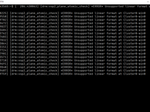

RK3568 + forlinx desktop:
在桌面系统上移动鼠标的时候,串口打印 [drm:vop2_plane_atomic_check] *ERROR* Unsupported linear format at Cluster0-win0;
只要移动鼠标,就一直打印。
请问是什么问题?

楼主| ARMer 发表于 2023-9-22 14:41:18 | 显示全部楼层
问题解决了;
方法是dtsi文件中注释掉以下内容,编译内核,烧写boot.img:
#if 0
&vp0 {
        cursor-win-id = <ROCKCHIP_VOP2_CLUSTER0>;
&vp1 {
        cursor-win-id = <ROCKCHIP_VOP2_CLUSTER1>;
#endif
========分割线======
以上内容有cursor,win,vop2,CLUSTER0, 与出错的信息内容相关,尝试了一下,居然解决问题了;
不了解以上内容具体含义,估计可能屏幕光标显示有关。
烧写重启后dmesg如下:

还有一个解决办法,“Unsupported linear format”这句出现在rockchip_drm_vop2.c文件中,注释掉这句,重新编译内核下载,串口终端也不会显示这个个错误了,只是觉得这方法掩耳盗铃。具体代码如下:
         * This is special feature at rk356x, the cluster layer only can support
         * afbc format and can't support linear format;
        if (VOP_MAJOR(vop2_data->version) == 0x40 && VOP_MINOR(vop2_data->version) == 0x15) {
                if (vop2_cluster_window(win) && !vpstate->afbc_en) {
                        DRM_ERROR("Unsupported linear format at %s\n", win->name);
                        return -EINVAL;
//看注释,似乎是光标或者HDMI在cluster上显示格式不对,也许是厂家驱动支持的显示类型不够完善;

forlinx@ok3568:~$ dmesg |grep 'vop2'
[    0.573831] rockchip-vop2 fe040000.vop: Linked as a consumer to fe043e00.iommu
[    0.580605] rockchip-vop2 fe040000.vop: [drm:vop2_bind] vp0 assign plane mask: 0x3f, primary plane phy id: 4
[    0.580631] rockchip-vop2 fe040000.vop: [drm:vop2_bind] vp1 assign plane mask: 0x0, primary plane phy id: -1
[    0.580653] rockchip-vop2 fe040000.vop: [drm:vop2_bind] vp2 assign plane mask: 0x0, primary plane phy id: -1
[    0.580797] rockchip-vop2 fe040000.vop: [drm:vop2_bind] Cluster0-win0 as cursor plane for vp0
[    9.423251] rockchip-vop2 fe040000.vop: [drm:vop2_crtc_atomic_disable] Crtc atomic disable vp0
[    9.489058] rockchip-vop2 fe040000.vop: [drm:vop2_crtc_atomic_enable] Update mode to 1280x800p0, type: 11 for vp0
[   11.395247] [drm:vop2_plane_atomic_check] *ERROR* Unsupported linear format at Cluster0-win0
[   11.395364] [drm:vop2_plane_atomic_check] *ERROR* Unsupported linear format at Cluster0-win0
[   11.395392] [drm:vop2_plane_atomic_check] *ERROR* Unsupported linear format at Cluster0-win0
[   11.395417] [drm:vop2_plane_atomic_check] *ERROR* Unsupported linear format at Cluster0-win0
[   12.153467] [drm:vop2_plane_atomic_check] *ERROR* Unsupported linear format at Cluster0-win0
[   12.153539] [drm:vop2_plane_atomic_check] *ERROR* Unsupported linear format at Cluster0-win0
[   12.153906] [drm:vop2_plane_atomic_check] *ERROR* Unsupported linear format at Cluster0-win0
[   12.153944] [drm:vop2_plane_atomic_check] *ERROR* Unsupported linear format at Cluster0-win0
[  609.439780] rockchip-vop2 fe040000.vop: [drm:vop2_crtc_atomic_disable] Crtc atomic disable vp0

按芯片内部结构 ,vp0,vp1,vp2配置1个给HDMI,其余禁止就可以了吧?
请问具体到dtsi文件中怎么配置?
dmesg显示启动过程就有错误提示了。
[drm:vop2_bind] Cluster0-win0 as cursor plane for vp0 好像跟鼠标光标有关系,移动鼠标的时候会打印那个错误信息,鼠标停止移动就不打印了。

问题解决了;
#if 0
这个是ubuntuR2版本上会有的问题,您可以看下用户资料里更新的ubutuR3版用户资料,这个烧写后不会出现这个问题,并且适配了硬解码等,不过目前在R3上可能有些小问题,比如hdmi热插拔不显示,正在尝试解决。
我如上解决问题后,好像没有引起其它问题,请问可以继续这样用吧?  详情 回复 发表于 2023-9-22 17:40

forqs 发表于 2023-9-22 15:53
这个是ubuntuR2版本上会有的问题,您可以看下用户资料里更新的ubutuR3版用户资料,这个烧写后不会出现这 ...
可以的,新版本主要是添加了gpu、vpu等的支持,优化原生can。  详情 回复 发表于 2023-9-23 08:46
