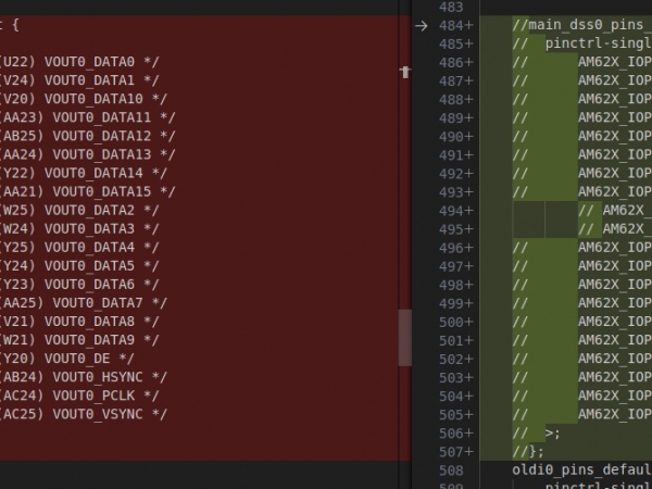

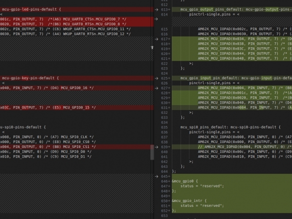

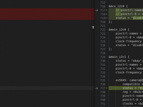

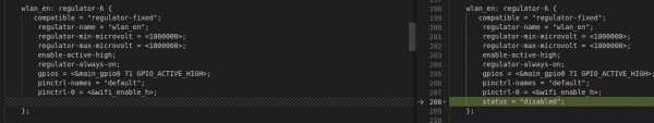

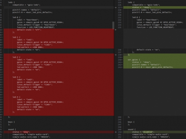

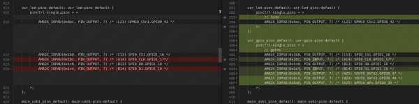

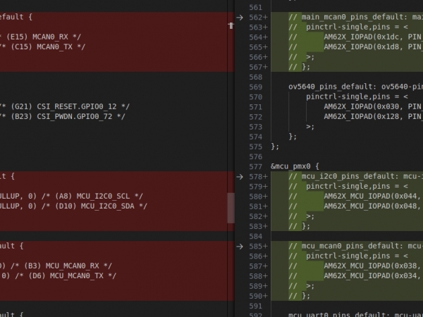

请问基于OK6321-C的核心板开发的硬件,A核的GPIO无法拉高是怎么回事儿呢?,比如引脚(W24) VOUT0_DATA3.GPIO0_48,测试结果如下图所示,哪怕外接了上拉电阻也不行
(具体修改见zip文件)
主要是修改设备树文件:arch/arm64/boot/dts/ti/OK62xx.dtsi
以防万一没有改完,把下面的设备树文件也做了修改:
arch/arm64/boot/dts/ti/OK6231-C-lvds.dtso
arch/arm64/boot/dts/ti/OK6231-C-rgb-lvds-dual.dtso
arch/arm64/boot/dts/ti/OK6231-C-rgb.dtso
arch/arm64/boot/dts/ti/k3-am625-beagleplay.dts
arch/arm64/boot/dts/ti/k3-am62x-sk-common.dtsi
更多图片 小图 大图
组图打开中,请稍候......
diff.zip

楼主| lhwdev 发表于 2024-12-19 19:17:28 | 显示全部楼层
测试结果截图没有传上来,复制如下:
root@OK62xx:/# fltest_gpio.sh 72 1
===72===1
root@OK62xx:/#
root@OK62xx:/# cat /sys/kernel/debug/gpio
gpiochip0: GPIOs 24-115, parent: platform/600000.gpio, 600000.gpio:
gpio-55  (                    |net-5g-rst          ) out lo ACTIVE LOW
gpio-60  (                    |id                  ) in  hi
gpio-62  (                    |RT9186              ) out lo
gpio-66  (                    |heartbeat           ) out lo
gpio-72  (                    |sysfs               ) out lo
gpiochip1: GPIOs 116-167, parent: platform/601000.gpio, 601000.gpio:
root@OK62xx:/#
root@OK62xx:/#

87岁拄拐上分 发表于 2025-3-12 09:41:38 | 显示全部楼层
把这个文件内的节点disabled掉试一试
&dss {
        pinctrl-names = "default";
        pinctrl-0 = <&oldi0_pins_default &main_dss0_pins_default>;
        status = "disabled";
