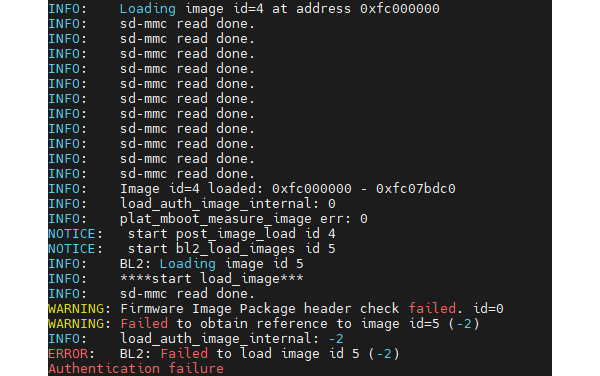

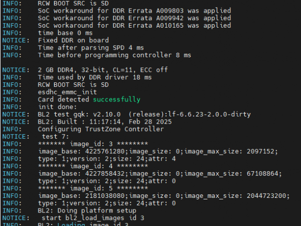

自己研制的1028A开发板,TF卡烧录时候TFA报错:有时是BL2阶段加载BL32( image_id: 4 )报错,有时是BL2阶段加载BL33( image_id: 5)报错。具体错误如下,请问该怎么解决此问题

INFO:    RCW BOOT SRC is SD
INFO:    SoC workaround for DDR Errata A009803 was applied
INFO:    SoC workaround for DDR Errata A009942 was applied
INFO:    SoC workaround for DDR Errata A010165 was applied
INFO:    time base 0 ms
NOTICE:  Fixed DDR on board
INFO:    Time after parsing SPD 4 ms
INFO:    Time before programming controller 8 ms
NOTICE:  2 GB DDR4, 32-bit, CL=11, ECC off
INFO:    Time used by DDR driver 18 ms
INFO:    esdhc_emmc_init
INFO:    Card detected successfully
INFO:    init done:
NOTICE:  BL2: Built : 11:17:14, Feb 28 2025
INFO:    Configuring TrustZone Controller
INFO:    ******* image_id: 3 ********
INFO:    image_base: 4225761280;image_size: 0;image_max_size: 2097152;
INFO:    type: 1;version: 2;size: 24;attr: 4
INFO:    ******* image_id: 4 ********
INFO:    image_base: 4227858432;image_size: 0;image_max_size: 67108864;
INFO:    type: 1;version: 2;size: 24;attr: 0
INFO:    ******* image_id: 5 ********
INFO:    image_base: 2181038080;image_size: 0;image_max_size: 2044723200;
INFO:    BL2: Doing platform setup

NOTICE:   start bl2_load_images id 5
INFO:    BL2: Loading image id 5
INFO:    ****start load_image***
INFO:    sd-mmc read done.
WARNING: Firmware Image Package header check failed. id=0
WARNING: Failed to obtain reference to image id=5 (-2)
INFO:    load_auth_image_internal: -2
ERROR:   BL2: Failed to load image id 5 (-2)
Authentication failure
image5 错误
image5 错误
