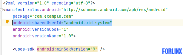

修改客户应用AndroidManifest.xml文件
添加android:sharedUserId="android.uid.system"

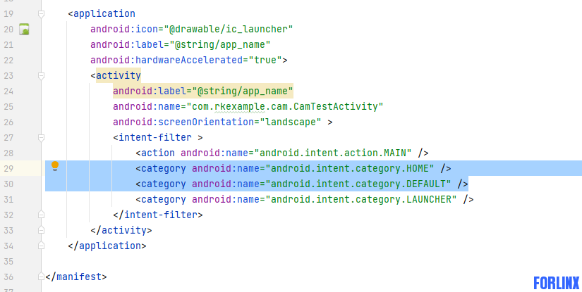

添加<category android:name="android.intent.category.HOME" />
添加<category android:name="android.intent.category.DEFAULT" />

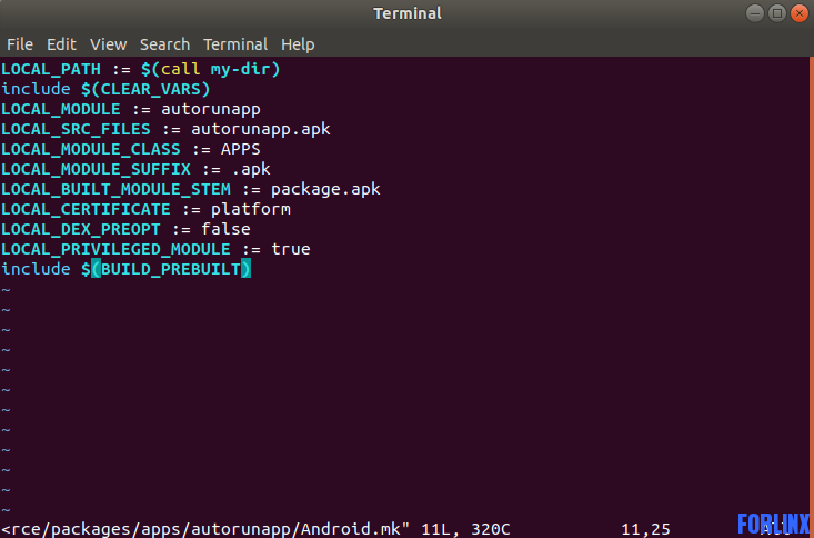

4 在autorunapp文件夹下创建Android.mk文件,添加以下内容
LOCAL_PATH := $(call my-dir)
include $(CLEAR_VARS)
LOCAL_MODULE := autorunapp
LOCAL_SRC_FILES := autorunapp.apk
LOCAL_MODULE_CLASS := APPS
LOCAL_MODULE_SUFFIX := .apk
LOCAL_BUILT_MODULE_STEM := package.apk
LOCAL_CERTIFICATE := platform
LOCAL_DEX_PREOPT := false
LOCAL_PRIVILEGED_MODULE := true
include $(BUILD_PREBUILT)

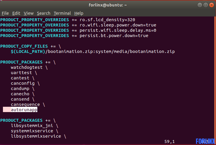

5 修改/OK3568-android-source/device/rockchip/rk356x/ok3568_r/ok3568_r.mk
添加客户app名称
