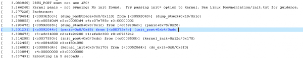

bian.hu 发表于 2015-8-11 10:24:51 | 显示全部楼层 |阅读模式
U-Boot 1.3.4 (Jul 30 2015 - 23:08:02) for SMDKV210
CPU:  S5PV210@1000MHz(OK)
        APLL = 1000MHz, HclkMsys = 200MHz, PclkMsys = 100MHz
MPLL = 667MHz, EPLL = 80MHz
         HclkDsys = 166MHz, PclkDsys = 83MHz
         HclkPsys = 133MHz, PclkPsys = 66MHz
         SCLKA2M  = 200MHz
Serial = CLKUART
Board:   SMDKV210
DRAM:    512 MB
Flash:   0 kB
SD/MMC:  Card init fail!
0 MB
NAND:    manufac=ec dev_id=dc
Nandflash:ChipType= SLC  ChipName=Samsung K9F4G08U0DNandFlash:name=NAND 512MiB 3,3V 8-bit,id=dc, pagesize=2048 ,chipsize=512 MB,erasesize=131072 oobsize=64
NandFlash Size is 512 MB
*** Warning - using default environment
In:      serial
Out:     serial
Err:     serial
checking mode for fastboot ...
Hit any key to stop autoboot:  0
NAND read: device 0 offset 0x100000, size 0x500000
Main area read (40 blocks):
5242880 bytes read: OK
Boot with zImage
Starting kernel ...
Uncompressing Linux... done, booting the kernel.
[    0.000000] CPU: ARMv7 Processor [412fc082] revision 2 (ARMv7), cr=10c53c7f
[    0.000000] CPU: VIPT nonaliasing data cache, VIPT nonaliasing instruction cache
[    0.000000] Machine: SMDKV210
[    0.000000] Memory policy: ECC disabled, Data cache writeback
[    0.000000] <8>On node 0 totalpages: 131072
[    0.000000] CPU S5PV210/S5PC110 (id 0x43110220)
[    0.000000] <8>s5pv210_setup_clocks: xtal is 24000000
[    0.000000] Console: colour dummy device 80x30
[    0.121096] Mount-cache hash table entries: 512
[    0.135878] et2_pud=4000
[    0.224938] Console: switching to colour frame buffer device 100x30
[    1.500416] ##########rtw_suspend_lock_init ###########
[    3.057329] <8>lib80211_crypt: registered algorithm 'NULL'
[    3.061373] <8>lib80211_crypt: registered algorithm 'WEP'
[    3.066728] <8>lib80211_crypt: registered algorithm 'CCMP'
[    3.072178] <8>lib80211_crypt: registered algorithm 'TKIP'
[    3.083969] DBUG_PORT must not use AFC!
[    3.266268] Kernel panic - not syncing: No init found.  Try passing init= option to kernel. See Linux Documentation/init.txt for guidance.
[    3.277228] Backtrace:
[    3.279654] [<c003bfcc>] (dump_backtrace+0x0/0x110) from [<c0592040>] (dump_stack+0x18/0x1c)
[    3.288055]  r6:c005f0d4 r5:c00083d4 r4:c07e795c r3:00000002
[    3.293675] [<c0592028>] (dump_stack+0x0/0x1c) from [<c05920bc>] (panic+0x78/0xf8)
[    3.301231] [<c0592044>] (panic+0x0/0xf8) from [<c00375e4>] (init_post+0xb4/0xdc)
[    3.308676]  r3:efc34000 r2:efe9c200 r1:efe9c300 r0:c0725912
[    3.314299] [<c0037530>] (init_post+0x0/0xdc) from [<c0008500>] (kernel_init+0x12c/0x170)
[    3.322455]  r4:c084d500 r3:ef801090
[    3.326003] [<c00083d4>] (kernel_init+0x0/0x170) from [<c005f0d4>] (do_exit+0x0/0x5f0)
[    3.333894]  r4:00000000 r3:00000000
[    3.337431] Rebooting in 5 seconds..
[    8.367991] Restarting Linux version 2.6.35.7 (bianhu@bianhu-virtual-machine) (gcc version 4.4.1 (Sourcery G++ Lite 2009q3-67) ) #1 PREEMPT Sat Aug 8 15:14:50 CST 2015
[    8.368002]
[    8.385058] arch_reset: attempting watchdog reOK
耳东的刀 发表于 2015-8-11 21:00:49 | 显示全部楼层
应该是bootargs设置不对
我用了同一个u-boot,bootargs配置参数都是一样的,首先我用forlinx提供的镜像能跑起来,而我用forlinx提供的内核源码,ok210p_linux_config的配置,编译的zImage确不能跑起来。  详情 回复 发表于 2015-8-12 10:31
20

nightwing 发表于 2015-8-17 10:53:19 | 显示全部楼层
bian.hu 发表于 2015-8-12 22:45
谢谢!试过了还是报一样的错
哦,真是遗憾。不过看上去你的启动信息好像不是很详细,也许你可设置一下启动 bootarg 设置
loglevel=7 将所有的信息打印出来,看看到底哪儿出了问题。我虽然是在 /linuxrc 那一步出有问题,但最终也是 出错提示在
Kernel panic - not syncing: No init found.   说不定你也是在那儿,可以考虑像我一样换换内核源代码。
