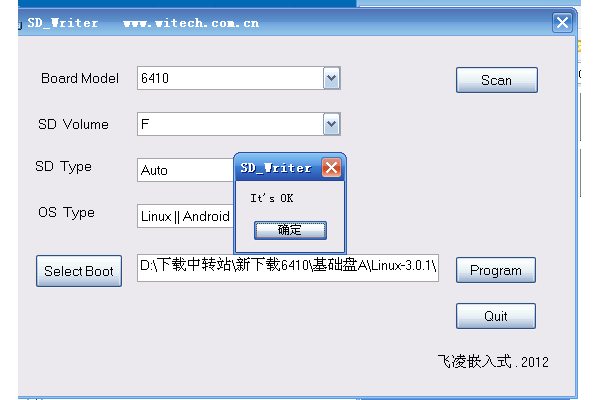

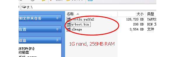

  •         (3).成功制作一键烧系统SD卡(如图),一下是输出错误信息:
  • Writing data at 0x6e6000 --  98弌mplete.
  • Writing data at 0x6f3000 --  99弌mplete.
  • Writing data at 0x6ff000 -- 100弌mplete.
  • 5242880 bytes written: OK
  • ** Partition 1 not valid on device 0 **
  • ** Unable to use mmc 0:1 for fatload **
  • NAND write: device 0 offset 0x700000, size 0x3f900000
  • Input block length is not page aligned
  • Data did not fit into device, due to bad blocks
  • 1066401792 bytes written: ERROR

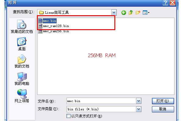

  • 2. USB线烧linux
  • (1).利用1制作好的SD,启动板子进入boot界面
  • uboot烧进去了。内核跟文件系统都烧成功了。(附上烧成功的串口信息)

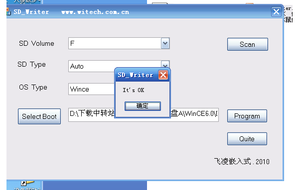

  • 3. WINCE烧写
  • 光盘里......\Demo\一键烧写专用文件\SD_Writer.exe    制作SD一键烧写后,设置SD启动,烧写失败log。

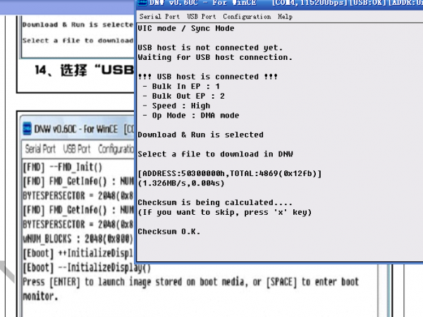

  • [Eboot] ++InitializeDisplay()
  • [Eboot] --InitializeDisplay()
  • Press [ENTER] to launch image stored on boot media, or [SPACE] to enter boot monitor.

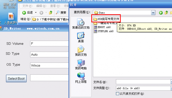

  • 4. usb线烧写。

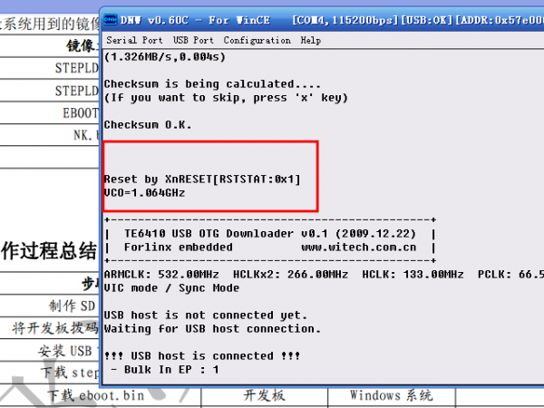

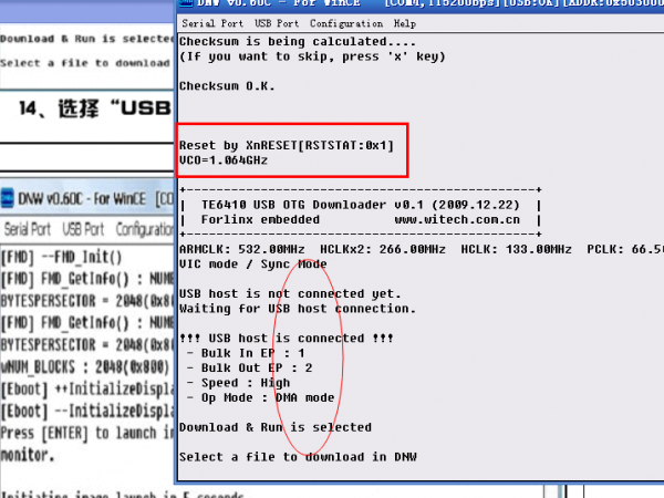

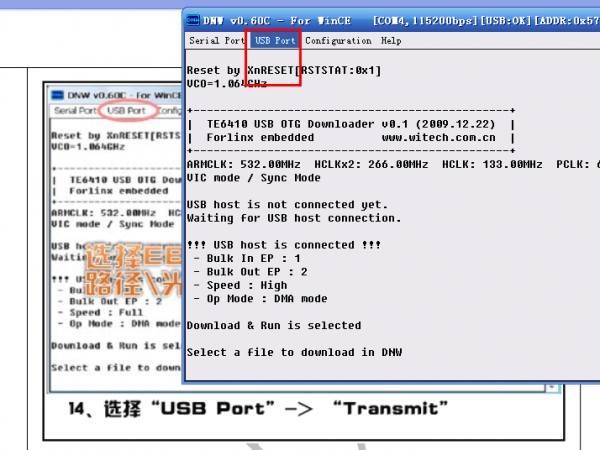

  • 用.....\Demo\USB烧写专用文件\SD_Writer.exe 和OK6410_SDboot.nb0制作好SD卡,SD模式启动,下载,最后下不进去。
  • 错误提示是:reset by XnRESET[RESTART:01]
